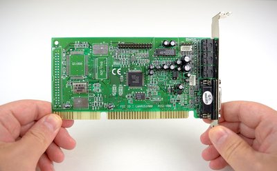

All cards based on the OPL3-SAx that I've seen have a 33.8688mhz crystal on them, which makes sense for the typical 44.1/22.05/11.025khz sample rates. But some of them have a 24.576mhz crystal, and some of them don't. These would more often be used to clock 48khz sampling rates.
The datasheet for the OPL3-SA3 for example doesn't say anything about these clocks besides the information given in the pinouts for each package.
For those that have had extended experience with these cards, what do you make of it?
Which cards don't have? If you post a link to a good high-res picture, the reason might be obvious.

Reply 2 of 3, by SaxxonPike
Phil's Computer Lab features the Audician 32 Plus, which is missing it:
http://www.philscomputerlab.com/audician-32-plus.html
211.3 KiB
401 views
However, my card is pretty much exactly the same, but with the crystal:
277.28 KiB
401 views

Reply 3 of 3, by Jepael
OK, I was only able to find YMF-715 datasheet but not YMF-719, they might be different in this regard.
In the YMF-715 datasheets there is an example how to use a PLL chip to generate both frequencies from a single crystal with a PLL chip.
But there is no separate PLL chip on the photo with single crystal, so that's not it.
So, the 24.576MHz is really missing from the board. Perhaps the YMF-719 has an internal PLL, but I don't know.
If that frequency is not absolutely necessary on YMF-719, maybe the drivers know from PNPID or otherwise detect it does not have the crystal so it does not use rates based on that clock.
But other than the info above, I don't have an explanation.
