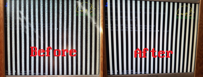

I've got a V3 3000 that appears to be a Gateway model based on the "G-WAY" 1.20 firmware sticker. I had tried this card in a P4 system that had a universal AGP slot (first making sure in the BIOS that it was set for 1x/2x mode) and had this same problem. I assumed it was the motherboard, because when I tried another AGP 1x/2x card in it (Rage IIc), it didn't work at all. Well, now I've got a Slot 1 motherboard that has an actual 1x/2x slot and still the same issue. Here's a video of it. Sorry about the background noise and the filthy monitor.
https://youtu.be/QvAt7j18fTM

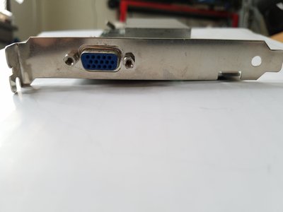

Reply 2 of 15, by F2bnp
Does the card have S-Video output? If so, can you get some footage out of it?
Reply 3 of 15, by Kyosho

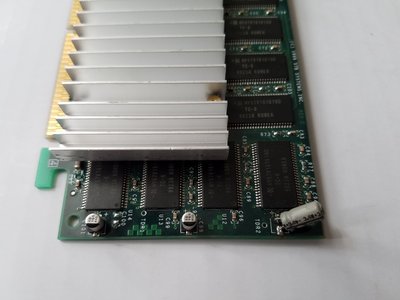

No S-Video, just VGA. I'll try and get some pictures up. I MIGHT have found the problem. I just went through and tried wiggling various components to see if anything needed some fresh solder or was loose. One of the capacitors broke off after barely touching it. Broke the leg clean off the cap. I've got one of the same value, though not the same package. Should work fine. It'll look a little out of place, is all. I'll update once I've put the new cap on and tested it. For some reason I have the feeling this won't fix it, but here's hoping.
Edit: Nope, the cap wasn't the problem. Though it changed the fuzzy white columns into solid white columns. Guessing the capacitor is for filtering. Will post again soon with proper pics of the card.

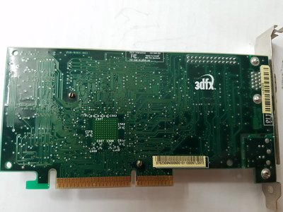

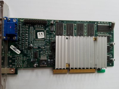

Reply 4 of 15, by Kyosho
Here's some pics. They're fairly high res so I think you can zoom in okay. If anyone wants a better pic of anything in particular, let me know. Also, I know my soldering job was kinda bad. Don't be hatin'. I'm in desperate need of a a new tip for my soldering iron. 😜

Reply 12 of 15, by Jade Falcon
Rank BANNED
BANNED
That cap if I recall is a filter for the ram, the cards can run without the filter but will be unstable or have fuzzy video output .
If you can get into windows try under clocking the card.
As for replacing the cap, something tells me that the damage cap may have taken the ram with it.
Also I don't ever recall seeing many voodoo 3000 without a s-video port. Are you sure that's not a voidoo2000 with a 3000 heat sink? Could it have 3k bios on it? Maybe it's unstable at 166mhz?

Reply 14 of 15, by havli
Non-TV-OUT Voodoo3 3000 are not so common but they do exist. Most likely this is one of them. And even if it was a flashed 2000, it should still work just fine... I haven't heard of a single one V3 2000 that can't handle the 3000 clocks. This looks like damaged memory.
True, but look at the layout of the card, nothing is the same as a voodoo3000, and the part number is for a S-video card. If I recall non S-video cards used a different part number.
I had a lot of voodoo3 cards and out of the bunch only one could not do 3000 speeds but it was just unstable and did nothing like this card is doing. I'd be more willing to bet my money on the bad memory too.
