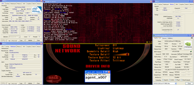

Reply 1 of 222, by agent_x007
And a year ago, I did all my scores with Trilinear Filtering 🙁
Example :

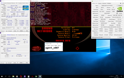

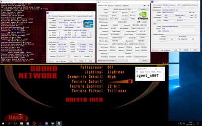

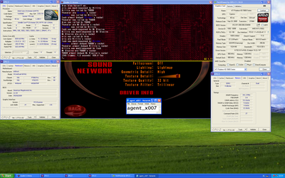

Reply 3 of 222, by agent_x007
926,4FPS with HD 5870 and crappy board + monster CPU 😀
The attachment [Demo001] Radeon HD 5870 (850-4800).PNG is no longer available
977,5FPS on Core i7 3820 4,65GHz and GTX 780 Ti (1024x768) 😉
The attachment Quake III Arena Core i7.png is no longer available
983,9FPS Core i7 3820 4,65GHz GTX 780 Ti (1600x1200) 😁
The attachment Quake III Arena Core i7 1600x1200.png is no longer available
I agree that Trilinear Filtering isn't worth point out with above GPUs 😜
