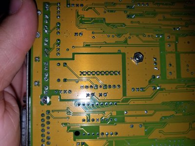

Reply 13 of 16, by bjwil1991
I looked at my other sound card, a Creative Labs Sound Blaster 16 WavEffects CT4170 that has the same chip, as well as traces for the Amp IC to the capacitors as well. I'm going to look at the Aztech card to see if there're traces from the Amp to the capacitors as well. If there is, would it be a good idea to swap chips around, and replace the caps, or just but a new IC chip and appropriate caps for that chip? Either that, or I can wait a while to replace those caps and the chip. When I have the volume for the left channel maxed out and the right channel 6 below the left channel, both speakers play audio without issues, but balanced volume or sliders in Windows 98SE or MS-DOS doesn't work out too well.
Edit 1:
Here's a snapshot of the traces between the chip and caps:
4.11 MiB
1027 views
Card traces
Edit 2:
Would it be a good idea to add solder to the pins on the chip that have rust or is that a bad idea?
Reply 14 of 16, by gdjacobs
Bypass the chip entirely. Either remove it or remove the caps required to disconnect it.
I mentioned a cheap way of tracing previously. This is what I was thinking of.
http://billmaudio.com/wp/?page_id=1254
