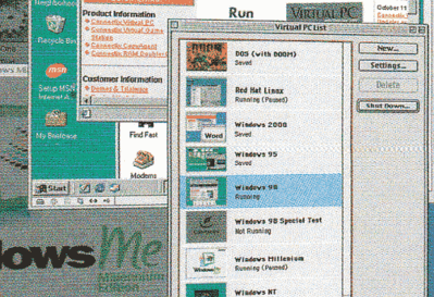

Reply 7 of 21, by Jo22
DosFreak wrote:
This thead was about two physical computers but if interested in VirtualPC then VirtualPC 5.1 was the last version for 9x.
Thanks for the tip! I thought of running VPC on the Win9x machine (with modern guest),
since it also has a folder sharing feature.
Jorpho wrote:
Can you really run operating systems like Windows 2000 or XP in such an old version of Virtual PC?
I would not have thought. I expect you'd at least need atypical amounts of RAM.
Hi, I assume you asked DosFreak - well, my box of Virtual PC v4 for Mac mentions 2K already (even Me! 😉 ).
It may not a pretty experience, but I believe it should run in 32MiB already, 😅
77.81 KiB
2840 views
Sammy wrote:
I use the FTP server on my Router to transfer files between my PCs and Smartphones..
Cool idea! Someone here at vogons recently also recommended to use a Raspberry Pi as a Samba server.
Using Samba (*nix) should solve a bunch of compatibility issues between the different generations of
NTLM and other SMB things..
Edit: Silly me! 😊 If it's only about connecting the old machines to one new one,
someone could do the whole VPC thing in reverse also..
