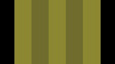

I have a small issue with DosBox games in Windows 10 and I'd like some help please.
Whenever I start the game it shows a black screen interrupted by part of the window behind.

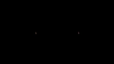

Whenever there is a transition between gameplay and a cutscene it shows either a cursor divided in two parts, or the last played scene before cutscene (like the screen is split into two and the colors are inverted).

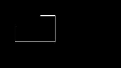

Plus when I choose to exit the game, there is a screen before it returns back to the desktop.

Please note that it takes about 2-4 seconds to make the transitions between cutscenes and gameplay and to get me out of DosBox.
