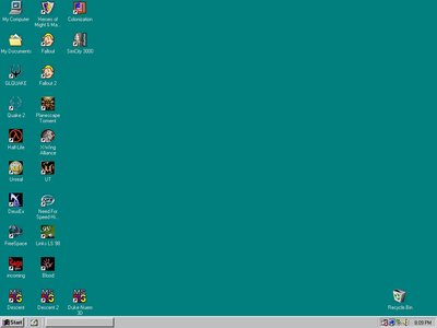

I've always had these on my Win98SE builds. Where when you close programs a blank button remains in the taskbar, which then goes away when you click it. If Origin programmed Win98, they'd say "It's not a bug, it's a feature." Usually my builds are straight 98SE installs with no service packs or OS patches. At most I install the NUSB patch and DirectX. Has ther ever been a patch to address this? Is it even worth it? It's a minor annoyance now, I'm just asking out of curiosity.

Here you go. See the blank taskbar button. This was left after I ran some timedemos in Quake II, then quit the game. It happens with other games too. When I quit the game, I get this phantom blank taskbar button. If you click it, it disappears.

The blank buttons are due to a disconnect between the taskbar and window state. The taskbar doesn't poll the various windows for updates to see if they are still taskbar eligible or not. Clicking the buttons forces an update. Sometimes the taskbar doesn't get notified when an app exits, why exactly this happens internally I'm not sure. I've noticed fullscreen OpenGL applications more often have this problem but it can happen with others too (might be something wgl related). It can actually happen even if everything is cleaned up correctly and destroyed.
If you have access to the app source code or want to fix your own programs, it's pretty easy - you can do something like this before destroying a window:
    ShowWindow(ctx->hwnd, SW_HIDE);
ex = GetWindowLong(ctx->hwnd, GWL_EXSTYLE);
ex &= ~WS_EX_APPWINDOW;
ex |= WS_EX_TOOLWINDOW;
SetWindowLong(ctx->hwnd, GWL_EXSTYLE, ex);
SetWindowPos
hwnd,
NULL,
0, 0,
0, 0,
SWP_NOMOVE | SWP_NOSIZE | SWP_NOZORDER |
SWP_NOACTIVATE | SWP_FRAMECHANGED
ShowWindow(ctx->hwnd, SW_SHOW);
... then destroy the window as you normally would ...
This forces a taskbar update before destroying the window, we hide it, change the style to one that isn't taskbar eligible, then show it again to force the update. It can still happen on Windows NT but seems very very rare in comparison. In general it is almost exclusively a Windows 9x problem.
