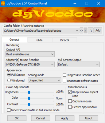

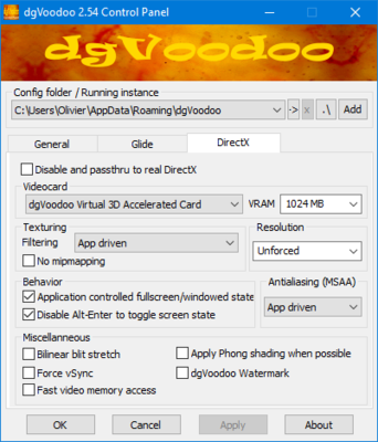

I made my tests with the game directory being user-writeable, and as I said it "works" with the fix, and quits silently with dgVoodoo. Maybe we're using different parameters on the game and/or dgVoodoo.
Here are my dgVoodoo parameters :
39.99 KiB
3335 views
dgVoodoo General tab
40.07 KiB
3335 views
dgVoodoo DX tab

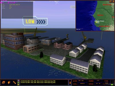

NovHak wrote:
Okay, I'm going to try this and come back here.
Btw, are you sure it really worked for you, for example by activating the dgVoodoo watermark, and that it didn't just simply find its way directly to the DX interface, bypassing Dégé's wrapper ?
Very sure:
357.04 KiB
3290 views

I notice on your screenshot that the color banding problem is still present. I was secretly hoping dgVoodoo would solve this too !
