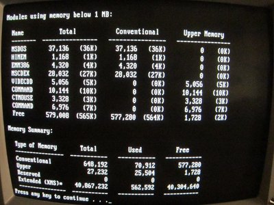

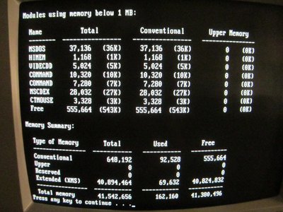

So, basically, I accidentally screwed up my MS-DOS Mode CONFIG and AUTOEXEC because I tried to make a change in EDIT and didn't realize that was stupid and it killed it. I go to PhilsComputerLab's website and see he replaced it with the Super Easy MS-DOS Mode PIF, so I download that and put it on my Windows 95 desktop. The only changes I made to it was removing the Turtle Beach line in AUTOEXEC and I of course installed my own sound card drivers. The issue is that while Expanded Memory + Mouse + CD-ROM is perfectly fine, Extended Memory + Mouse + CD-ROM gives me very little conventional memory for some reason. I can't run many games at all, like Duke Nukem II or even Commander Keen IV, because they all give out of memory errors. This wasn't an issue until now, so any help would be very appreciated. Thanks.
Available Memory:
Expanded + Mouse + CD-ROM:
565KB
Extended + Mouse + CD-ROM:
543KB

Reply 1 of 12, by gdjacobs
Run mem /c/p to find out what's occupying your conventional memory.
Reply 2 of 12, by thepirategamerboy12
Alright, here are the results:
The attachment IMG_5306.JPG is no longer available
The attachment IMG_5304.JPG is no longer available
Reply 3 of 12, by dr.zeissler
change "mscdex" to "shsucdx" and you will save a lot of RAM. (but it's slower)
Reply 4 of 12, by clueless1
Do you have five hdd partitions? If you lower your lastdrive= line, you can save a wee bit of memory. Similarly, you can reduce your files and buffers to save a bit of RAM. Some games require more, some less. 40 is a nice safe high number, but you might be able to get away with going as low as 25. Just test your games and bump them up as needed.
Also, move your DOS=HIGH,UMB line out of the common section and into each section below (not into the Conventional sections, obviously). It should be right after the HIMEM.SYS line. I'm not sure when it's in the common section if it gets processed in the correct order.
Finally, you can run memmaker to try and find some contiguous blocks of upper memory to fit your drivers in, or try including some offlimits memory regions to increase available memory. Try adding I=E000-EFFF to your EMM386 line. Memmaker might also find some other areas that are potentially safe to include.
edit: I=B000-B7FF is another region you can try (area reserved for monochrome monitors).

Hmm. It seems like games that require XMS typically don't require a lot of conventional memory. Do the games that are giving you troubles require the CD? Maybe you can run them on the XMS without CD option?
Did moving the DOS=HIGH,UMB line help free up conventional memory on your XMS option? It should look like:
[XMC]
DEVICE=C:\WINDOWS\HIMEM.SYS /TESTMEM:OFF
DOS=HIGH,UMB
DEVICEHIGH=C:\DRIVERS\VIDECDD.SYS /D:OPTICAL

thepirategamerboy12 wrote:
Actually, I think I've come up with a solution. I've adjusted the FILES and BUFFERS for every menu option and that seems to be working out so far. Though I guess I still need to do some more slight tweaks because my sound card config program doesn't seem to start in Extended + Mouse + CD-ROM but otherwise it all seems okay from what I've tried.
At some point in the past I ended up moving everything out of the COMMON section. It gives more flexibility. The conventional memory sections do not need DOS=HIGH,UMB; LASTDRIVE= can be one letter less on the sections that do not load the CD; and FILES/BUFFERS can vary more flexibly.
Also, I just took a peek at my CONFIG.SYS, and I actually have DOS=HIGH,UMB at the top of each section, above FILES, BUFFERS, LASTDRIVE, and HIMEM.SYS. Worth a shot. Also, I just noticed on my XMS with mouse and CD section, I have 584KB free. I'll see if I can paste that in in an edit for you to see.
edit: I think our differences are related to me using pure DOS 6.22 vs your Win9x MS-DOS mode. But here's my results for XMS with CD and mouse:
Modules using memory below 1 MB:
Name Total = Conventional + Upper Memory
MSDOS 15,325 (15K) 15,325 (15K) 0 (0K)
HIMEM 1,168 (1K) 1,168 (1K) 0 (0K)
VIDECDD 5,024 (5K) 5,024 (5K) 0 (0K)
COMMAND 2,992 (3K) 2,992 (3K) 0 (0K)
MSCDEX 27,952 (27K) 27,952 (27K) 0 (0K)
CTMOUSE 3,328 (3K) 3,328 (3K) 0 (0K)
Free 598,384 (584K) 598,384 (584K) 0 (0K)

I noticed that if I REM out my HIMEM.SYS line, I get similar results to you. MSDOS USES 67KB rather than 15KB and COMMAND uses 5KB rather than 3KB. I end up with 531KB free. According to your screenshot, HIMEM.SYS is loading, but it doesn't seem to be reducing the amount of conventional memory that MSDOS AND COMMAND use. Maybe try some troubleshooting with MSD.EXE in the memory section. Also try REMming out HIMEM.SYS on your XMS with CD/mouse section section. See if MSDOS uses more than 36KB and COMMAND.COM uses more than 10KB. If they do, then you know that HIMEM.SYS is working.
