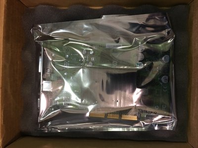

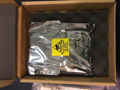

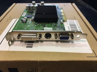

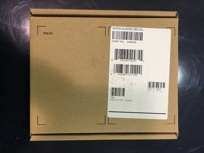

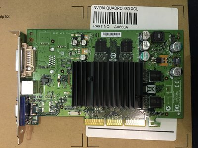

Well I have been promising pictures and this will at least get it started. Here is the unboxing of the HP Quadro4 380 XGL Video Card.
1.92 MiB

Reply 16 of 48, by squareguy

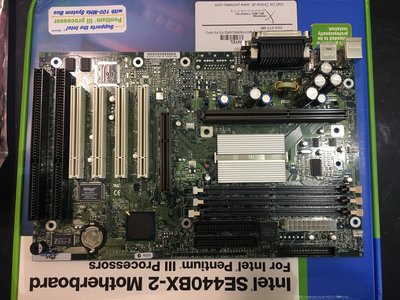

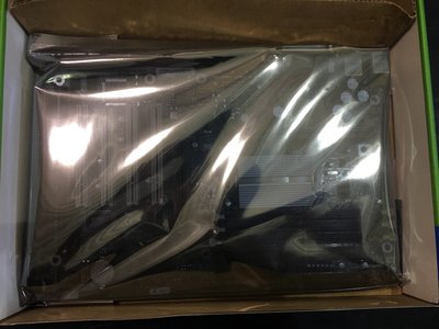

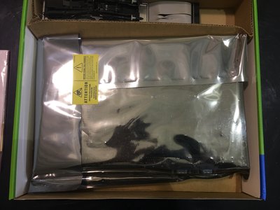

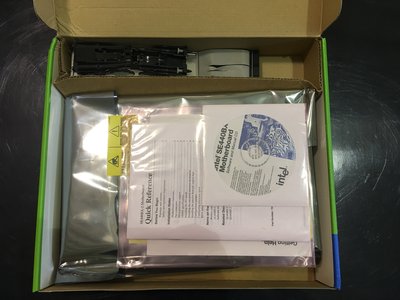

Unboxing the motherboard.

Reply 18 of 48, by squareguy

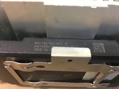

Reply 19 of 48, by squareguy

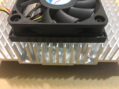

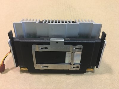

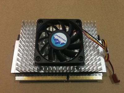

CPU: Pentium III 850
I have a 800 and 850 with identical heatsinks and fans. In the last photo you can see the plastic fan holder that I epoxied onto the heatsink and then the fan screws into that.
I think I found a case that is different from what I normally use and I might have to change heatsinks if I have clearance issues.
