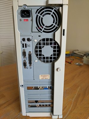

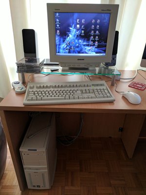

First build I've posted here and I'm quite pleased with how it turned out. 😀 The original computer was a Dell Dimension XPS M200a with all of its original components except the hard disk (seller did not include one). So, it's not a "full" build in that this is based on an OEM machine, but even still, I swapped out / upgraded a number of things and cleaned the whole thing up quite a bit!
This computer is built to be pretty close spec-wise to my dad's computer from that time. Why? Well it was 20 years ago this year, and it holds a certain fondness for me. The computer technically was my dad's, but we (my siblings and I) were able to play some games on it too 😀. I remember my parents occasionally buying me an issue of PC Gamer and I would ogle over the articles and ads for different PC hardware. In particular I remember I really wanted a Voodoo graphics card. Then in 1998, I wanted a Voodoo 2. Of course we never got any such thing. 😜 I didn't get my first part time job until a few years later when I was a bit older so I had no money to buy these things for myself either. So this build is basically a combination of what I remember from that PC and some of the additional hardware I wished we had.

Missing is a pair of beige speakers. I stupidly tossed the set I had a few years ago. They were actually the original set used with my dad's PC back in 1997! D'oh!

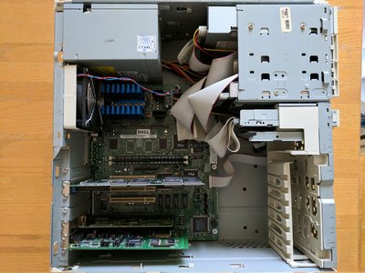

The CD-ROM drive in there now is the same model as what the computer originally came with, but the actual drive itself is a replacement as the original one had a lot of trouble reading CDs that worked perfectly fine in other computers. I wanted to see if I could get a replacement drive that was the same model, since it matched the beige colour of the case so well. Found one on eBay and bought it. When it arrived I discovered that I had not paid close enough attention to the photos in the eBay auction (dumb mistake!). The colour was most definitely not beige! However, since the original drive that wasn't working was in otherwise great cosmetic condition, I decided to just open them both up and swap the faceplates and CD tray and voila! Problem solved.
Since it was sold to me with no hard disk I had to put in my own. Luckily, even though a few years back I went on a "cleaning frenzy" and tossed out a bunch of old computer stuff (which I totally regret now), I did not toss any of my old IDE hard disks and still have a stack of five that all work. I decided to put in an 8.4GB drive. The next smallest IDE drive I have is 40GB and that doesn't seem too period-correct to me, heh. This drive is actually one I originally got with a P3 500Mhz HP Vectra computer that was actually my very first eBay purchase in 2003! (I wish I still had that computer 🙁) In this particular Dell model, the hard drive was apparently put in this vertical little beige plastic cage-thingy at the bottom front of the case somehow. That seemed really bizarre to me so I decided to instead mount it in the empty space up near the CD-ROM drive.
I haven't done the math on the PSU yet to see if I'm anywhere near close to its capacity. One of the main problems with these OEM computers is that they typically come with underpowered PSUs. I probably should check into that soon. The adapters for Dell's proprietary connector are easily obtained, so getting something a bit beefier shouldn't be a big problem if it's needed.

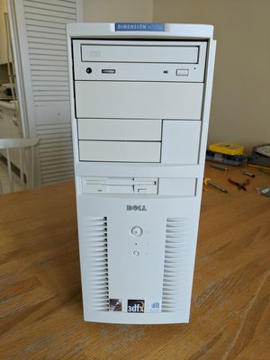

I love this particular style of Dell case. Never really been a fan of Dell computers otherwise. The computer my family had back then actually was not a Dell, it was a custom build by the owner of a computer store in a nearby town we knew. However, when I came across this Dell computer for sale a couple months ago I figured "why not", since I didn't have a clear memory of what the case we had looked like anyway so would be picking something different anyway.
Not really any yellowing except for a little bit on some of the empty bay covers. There are a bunch of little nicks around the seams of the removable parts on the case, probably from previous owner(s) who didn't have a clue how to open it up. Can't say I'm completely unsympathetic, as these Dell computers aren't really super obvious as to how you're supposed to open them (even the manual is kind of poor at explaining it in a few places). Especially if you're used to modern tool-less cases.
The computer arrived super dirty, tons of gross dirt, parts of dead bugs, etc. Cleaned it up, scrubbed all the plastic parts down and I think it looks great now personally. Very happy with this computer!

I've got the later Slot 1 based XPS-T500 which has a different faceplate but inside is all the same.
Mine also didn't come with a HDD and mounted it same as you under the floppy but that's cause I didn't know that was the purpose of "the cage" till someone pointed it out here. Still thinks its dumb and left the HDD under the floppy.
The non standard ATX will get a lot of hate, somewhat justified, as it is a pretty crappy trick to still have the connecter work. but the PSU's themselves are undeniably good quality and not "OEM crap" and no amount of Voodoo's, sound cards, whatever will come close to the power needed for 4 old IDE drives which this would have at least been rated for.
That said I do have an adaptor put aside as nothing lasts forever and I'm not good enough at electronics to repair PSU's
Reply 7 of 23, by oeuvre
If you remove the filler on the front panel connector with a needle, it should fit in many mATX/ATX motherboards.

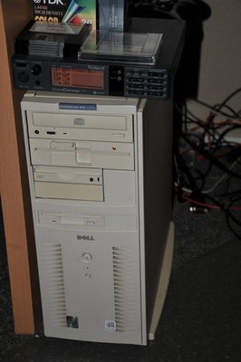

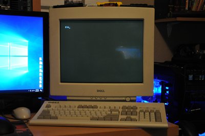

I've got a similar setup, except mine has a 200MHx MMX CPU. I also have the original Dell monitor, mechanical keyboard, and ball mouse that was bundled with the PC when purchased by my dad for work in 1997. I noticed that model # is M200a which would imply it came with a 200MHz CPU, was the CPU upgraded successfully? I have a XPS M200s and was told it could not be upgraded to 233MHz. It originally had W95 on it but I replaced the hard drive and installed W98SE. At first it ran noticeably slower than W95 did, but after I upgraded the RAM from 64MB to 128MB it now runs just as quickly as W95 did with 64MB. I am going to preserve the original 1.5GB hard drive as it has all my dad's old work files and a bunch of MS Paint stuff I did when I was a kid.

And yeah, I apparently neglected to mention exactly what I upgraded from the original parts, but the processor was one of the things I upgraded. As you say, it originally came with a 200MHz CPU and I swapped it out easily with a 233MHz just to max it out that little bit more. I'm not sure why you were told that your M200s could not be upgraded, but it certainly can. I was referencing the Dell XPS M__s manual for my M200a (couldn't find the M__a manual anywhere!), mostly for the correct jumper settings. As you'll be able to see in there (page 1-15), 233MHz is a fully supported configuration by the motherboard. That's assuming that someone hasn't gone and made some significant changes or something with your M200s anyway, heh.
Interesting that you noticed a speed increase going from 64MB to 128MB. I guess Win98SE must have been swapping to disk a lot more and the extra RAM helped to keep that from happening? I thought I had read somewhere that this particular Intel chipset can only cache stuff in the first 64MB of RAM, and that upgrading beyond (e.g. to 128MB) could actually slow it down! Maybe I misread?
