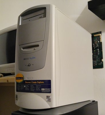

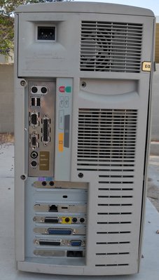

This, is the HP Pavilion 8275. This machine, is the physical embodiment of your serious gamer and workstation user at home just after the mid 90s.
I am a proud owner of this scarce system, and I very proud to let it be noticed by the world for possibly the first time. It really does appear that this machine was just never noticed back in the day and was not widely sold.

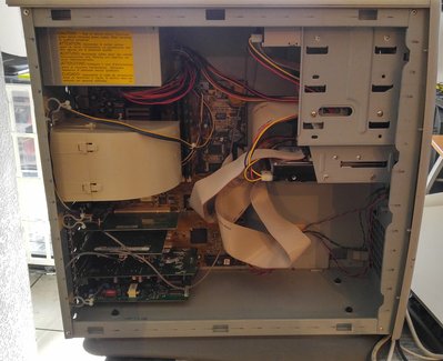

So, what's under the hood of this beast?
Well, this thing shipped with-
CPU: Intel Pentium ii 300Mhz
RAM: 48MB DDR (PC100) RAM
GPU: Integrated 4MB 3D capable chip
HDD: Quantum Bigfoot 8GB HDD
OS: Windows 95
Now, how did I even manage to get this machine? Well, earlier this year when I still worked at a computer repair shop that is now closed for good, once in a very great while we would get an elderly person with a surprisingly older machine. So upgrades to that degree were less common, but in this case... This was the oldest anyone has brought in. My close friend and manager at the store was the only one there when a lady brought this monster of a tower in. It was a data transfer to a flash drive job. My friend knew exactly what needed to be done, he offered the lady $20 to take the machine off her hands, she gladly accepted the offer, and shortly after I arrived. The sheer presence of the machine was just a bullet to the chest. It was impossible to miss, its appearance breathtaking, its age and era it comes from, interesting. I asked my friend if the lady who owned it wanted to sell it, and he told me we already bought it.
I was pretty much jumping with joy, I had never seen this machine before in my life, and I'm sure most of you haven't either.
Anyways I took care of the data transfer job, and sadly the lady wanted to keep the hard drive, and for some reason stole the RAM out of it... How someone so computer illiterate could do that is beyond me, but she did it. So, I had to throw in my own drive (which seems to have stopped working as of this post), and I installed Windows XP SP2 for some gaming.
That is the story of how I got it, nothing exciting, other than the astonishingly low price I got it for.
The specs now are:
RAM: 256MB SD (PC100) RAM
GPU: Nvidia GeForce 6200 512MB PCI
HDD: 60GB Maxor 7200RPM
OS: Windows XP SP2

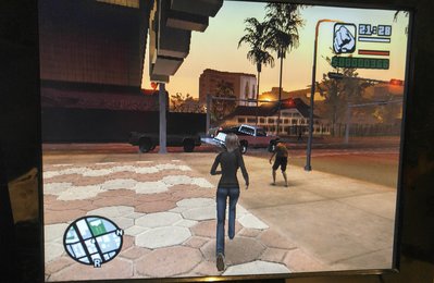

Here is a picture of it running GTA SA with mods;

Very nice system. It's also very well kept for its age, with no yellowing whatsoever.
Are you planning to expand it? If I'd be in your shoes, I'd max the RAM out, install a USB 2.0 card and reserve a flash drive for Eboostr (since you've installed Windows XP, trust me, additional cache will help to speed your system up!) and put the fastest graphics card you can get, as long as it uses an AGP slot (and if it's a universal one, it's even better!).
One little thing though: the computer uses SDRAM modules, not DDR ones. Now it just needs a matching HP monitor, keyboard and mouse. 😉

Looks like there's an ATI Rage chip on the board. That's probably why there's no AGP slot - they used AGP to attach the onboard graphics. I wish manufacturers had not done that. It would have been nice of them to attach onboard graphics via PCI and leave an AGP slot available. It's much more useful for addon cards then it is for some onboard chip.
I was trying to find what chipset this motherboard uses but I see what you mean about all the RAM/etc spam. Didn't find any real info on the system, but it's probably a 440LX/EX. It could be a 440FX (which has no AGP) but that's very early and pretty uncommon.
The capacitor vents look like Sanyos, which is good news. I see the BIOS chip has a label that says "PPA3" or something like that. Maybe that's a clue to the motherboard's real identity.

Servers usually put the Rage on the slowest of their PCI buses, keeping the faster bus(es) available for high performance controller cards.
Desktops, on the other hand, use it to amputate the fastest expansion bus in the system. It probably juiced up their Winbench scores slightly in magazine articles. 😀 My take on it is that if the performance impact of putting the Rage on PCI vs AGP is enough to bother the user, then they'll want an addon card regardless.
To be fair though, at that point in time PCI graphics cards weren't yet at a huge disadvantage vs AGP, so if an owner of this type of system had to upgrade to a PCI graphics card it wouldn't have been the end of the world. Still an annoying design choice though, IMO.
I guess the best solution is allowing the onboard AGP device to be bypassed when an AGP card is inserted, but it seems it took a while before motherboards/chipsets started to be capable of that.

How on earth is that thing running GTA San Andreas! I remember getting around 20fps at 800*600 on a 1.7GHz single core vista laptop with intel 945 graphics.
I would imagine that laptop was not well rounded and had 400 gallons of bloatware.
It vastly depends on your selected OS, background tasks, and graphics settings in the game. It's possible you had a Celeron D laptop which has a microscopic amount of cache, half as much as any Pentium ii in fact.
Every PC is capable of so much more, it would just take years and years of extra development to make sure EVERY PC is taken full advantage of like consoles are...(for the most part)
Also, I use the PS2 console as a reference to guess (if the system requirements signify SSE instructions or higher are required) if a game will run on MMX instructions. Almost guaranteed, if the game had a PS2 and PC port, the PC port runs on MMX instructions. So technically, the oldest/slowest technologies that can run games from that era, are Pentium Overdrive MMXs and Pentium MMXs, Which I sadly can't get working in my Gateway 2000 properly, I would imagine acquiring a system that was designed with a Pentium MMX would fix the issue.
