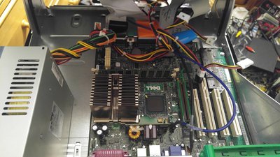

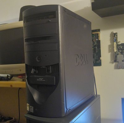

This, is the Dell Optiplex GX150, and it is one of the most flawlessly clean and well kept PC I have ever received used. While the outside appears to be a little banged up, the insides, just have a bloody look!

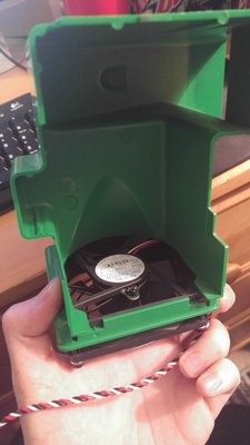

It's practically new in there! The funny thing is, I didn't even clean this out to my best abilities, I guess I didn't need to. I have barely touched this system since I bought it, the video linked at the end of this post is the third time I ever used this PC. I feel a little bad for not using it, it's a really nice system.
The specs are (and are maxed out to the best of this system's abilities)
CPU: Intel Pentium iii Tualatin 1.20Ghz 256MB L2 Cache
RAM: 384MB PC133 (128MB and 256MB sticks)
GPU: AGP Nvidia GeForce 6200 256MB (I have like 10 GeForce 6200s, so expect to see this every time)
HDD: 30GB Western Digital
OS: Windows XP SP3 (I need to really wipe and reload it to improve performance..)

Someone was confused about how it was clean.
As I said the system APPEARED dirty beyond cleaning, but surprisingly a lot of air compressor use and a little bit of windex made this thing way more clean than 90% of my systems, which says a lot becauze I keep my systems spotless.
And no, I have tried two 256MB sticks in each slot, and RAM slot 1 does not like anything above 128MB. I do not have any plans of upgrading the CPU of this machine, I have a thing for lower frequency CPUs.

These systems have onboard Intel AC97 audio and I assume he's using that since there's no sound card in the inside picture. Mine has a Sound Blaster Live! PCI sound card.

Those are good boards, they seem very well made and reliable.
You have the more desirable version also - most GX150s are Coppermine-only but yours is the later version which supports Tualatins.
Just so you know, the GX150 uses a standard ATX power supply. There's confusion about that with Dells sometimes.
I don't know why it's not working, but the GX150 definitely supports 512MB. I think I've even used a single (16-chip) 512MB module in one, but I've definitely used pairs of 256MB in them. I had one running long term that way.
It should work with the same RAM that works in other i815 boards, the only special issue I can think of is that Dell BIOSes actively refuse to boot with unbuffered ECC modules ("normal" boards just ignore the ECC and run with them).
