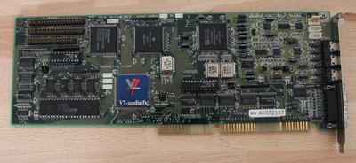

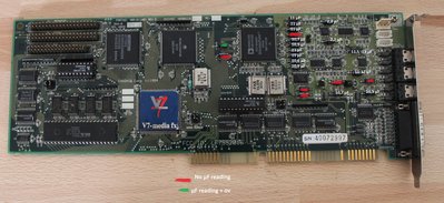

Hey people,
I'm trying to repair a Ensoniq Soundscape S 2000 clone, the Spea Media fx. I just checked the capacitors and found 7 dead ones, should be a good place to start. The thing is that some capacitor have unexpected ratings, for example the one dead capacitor in the row of the 10 caps (I hope you know what I mean, the ones next to the Analog Devices chip) has a rating of just 1µF instead of 10µF like any other in the row. The soldering job looks factory but I just wanted to double check. The problem now is that I couldn't find any picture on the internet of my exact card, all other have a different layout in the top right corner of the card.
So question is does anybody have a card that looks like mine and could check the ratings on the marked caps ?

Reply 2 of 30, by moturimi1
I have the card but with SMD caps.
There are only 1 or 10 micro Farad Caps. So your ready of 2.2 and 11 is 1 and 10.
Both caps on the left side of the AD chip have 1 microF ratings at 50V. Most of the red markings are also 1micr Farad.
Will look up all caps later

Reply 4 of 30, by Eleanor1967
Well I somehow managed to miss that thread 😉 All the ratings in question I could read from the pictures in that thread !
I just assumed because the smd caps are arranged a little different that the board layout would also be different but it seems that this is not the case. Should have looked a little closer 😀
Thanks for the heads up!

Reply 6 of 30, by Eleanor1967
Predator99 wrote:
Main point was: I would double check the solder joints before exchanging the caps 😉
I messured the caps with the multimeter right at their legs before they go into the cap. If I don't get a reading there it should be dead no matter how good or bad the solder joint is, right ?

Reply 9 of 30, by Eleanor1967
derSammler wrote:
You would need to desolder the caps in order to correctly measure them.
Generally yes, but since my caps are laid out the way they are, it doesn't matter if I measure them in circuit or not? The measurement happens between the two multimeter cables, right?
Predator99 wrote:
Not the joints at the caps..at the ICs, as written by FesterBlatz: "I'd like to note that this is my THIRD Ensoinq sound board with poor quality soldering on the fine-pitch chips. I've had two OPUS boards from eBay were the OPUS chips were literally falling off of the PCB! "
Ah, got yaa. At first glance it looks fine, but I will give it a go with the multimeter anyway. Thanks !

Reply 12 of 30, by Eleanor1967
@you both over me
Maybe I'm just tired, but I still don't understand why I cant measure my axial capacitors by connecting the multimeter to both sides on the front of the pcb. Doesn't the current take the shortest way possbible, which is right to the capacitor ?

Reply 14 of 30, by Eleanor1967
cyclone3d wrote:
Doesn't work that way. It will measure everything in the circuit. Not only will you get a measurement from the capacitor, but from everything on either side unless nothing at all completes a circuit.
Well okay, (and thanks to you all for this private tutoring 😉 )I guess this explains why I always get a +1µF on any working capacitor. Is it still safe to assume that any capcior I tested and got a reasobable reading is good ?

Reply 17 of 30, by Eleanor1967
I just desolderd the first cap, one of which I didn't get a reading before, and it is perfectly fine out of the circuit. So much for my hope of this being any test worth a damn. I ordered some new caps, gonna recap the whole thing and go from there.
