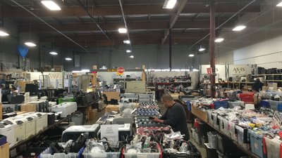

RE-PC here in Seattle. This place was probably amazing back in the day but the staff has realized how much stuff goes for on eBay and acts accordingly (my initial impression). But if you need a 50 pin SCSI cable quick, it works. 3 cards I bought here were DOA.

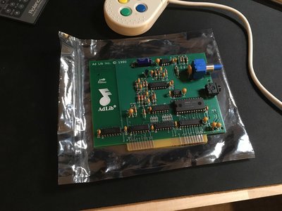

Finished card at home. So excited to see if it works!
632.25 KiB
1664 views
Well, she fired up with no smoke!
