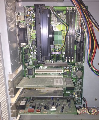

Thanks to a visit to my parents' house, I was able to recover my old BX mobo that I cycled to my sister and mother years back. The Socket 370 got donated, but this one survived!
Undecided what I want to do with it yet. I've got 286/386 restores set aside and functioning 486/P200 builds, so perhaps it is time to start moving forward a bit. Sitting on other AGP/PCI options at home. But for now this is an Epox BX3 with a Pentium 3 500MHz in it. AGP + 5 PCI + 2 ISA with SBLINK. 3 RAM slots.
Inside as-is with tons of dust:

I stripped out the cards and the mobo/proc from the case. Wow! Apparently I was in a hurry to get this one out of the way at my parents house when I upgraded the lowest common denominator computer (this one) at the time. The screws didn't fit the standoffs and were jammed in. Despite how embarrassing this is, I think it is worth noting that this *most* likely happened because I was on the verge of tossing everything out for recycling... but this one somehow survived - It was most likely moved to the attic at my parents' because they weren't sure what I wanted to do with it.
80.95 KiB
1374 views
After getting the screws out of the standoffs, I blew out the processor and the surface of the mobo with some compressed air. I think there were a few intermittent contact issues with the processor and motherboard at the start - I had some non-boot instances and some freezes. I dropped down to 1 stick of RAM and threw in an ATI Rage Mach 64 that was hanging out nearby. Not willing to admit it was just the capacitors and after making sure the proc was once again secured properly, I fired up.

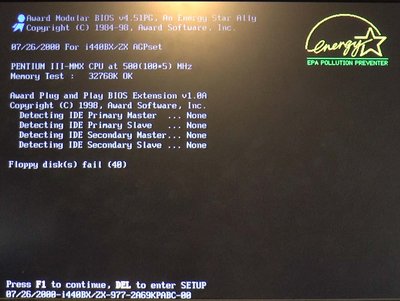

I used a "bench" computer PSU, placed the board on a digikey box (nice, low profile), and fired up (bad cap still in circuit).
137.05 KiB
1374 views

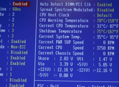

Hmm. I pulled a support page for Epox from archive.org, and it looks like this isn't quite the most recent BIOS.
(7/26/2000 flashed vs 9/20/2000 on website. Apparently, the latest version adds 65 GB drive support)
108.85 KiB
1374 views
BIOS played nice. I was able to reboot a few times after tweaking/saving settings.
So now I gotta decide what direction I want to go with the caps. I am tempted to just ignore the problem. Then I think, "well, I could replace the one cap." Then I think, "Might as well replace them all if you are going to bother..."
I suppose it depends on what sort of time commitment I want to make.

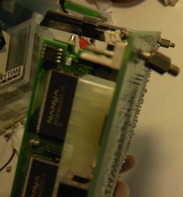

Case has been cleaned out and motherboard mounted. I found some RAM to put in it. The BX board is naturally quite old and can only use half of one particular stick, but thanks to two additional sticks, the RAM is up to 256 MB.
Setbacks -
1: The 40 GB hard drive that I found in my garage has started slamming the head into the side of the drive. It recovers after a bit of this, but this early warning sign gives me no reason to proceed with this drive, sadly.
2: I have a fairly decent PATA Seagate 250 GB drive that could serve as a 137 GB drive to max out Windows 98 S.E., however the BIOS hangs when trying to detect it. I know I don't have the latest BIOS installed, however the final BIOS adds support for drives up to (only) 65 GB. So I am a bit undecided as to what I want to do next. I may have some other drives around in the 20-40 GB range. We'll see.

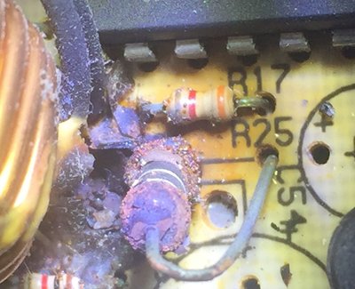

In the process of recapping the power supply. Found a burned out resistor near the PWM IC. You can see the terrible glue they used in the surrounding area. Tough to get a reading on the resistor. I have it out of circuit and am going to try to sand the legs a bit.
I would suggest finding the supervisory IC, locating a datasheet for it, and checking which trace corresponds to the current sense pins. If the resistor is used for current sense, it will be quite small, so you can sanity check your results.

So the PWM is a TL494 IC, and that resistor has one end tied into the secondary auxiliary rail - on the side that hits pin 12 (Vcc) of the IC. Momaka of badcaps mentioned that of the half bridge PSU schematics he has, most of them tend to use a 1.5kOhm resistor there. So I will probably pick up a 1.5k, 2 watt resistor...and perhaps a few others with some lower resistance just to have on hand. I'll throw them in with the cart of caps. Meanwhile, I gotta clean off the various old glue spots that are turning brown (and in this case, black).
PWM - http://www.ti.com/lit/ds/symlink/tl494.pdf
