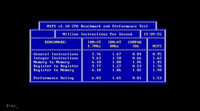

Reply 17 of 17, by superfury

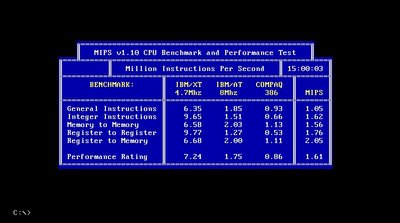

A little update on the current 80386 timings(with the new DX/SX behaviour and PIQ fetching, as implemented in the above post):
102.01 KiB
411 views
Compaq Deskpro 386 - 386DX running MIPS 1.10
102.04 KiB
411 views
Compaq Deskpro 386 - 386SX running MIPS 1.10
Of course the same kind of improvements happen on the 80286 CPU, which is also a bit faster due to the new word fetching from memory and from PIQ.
