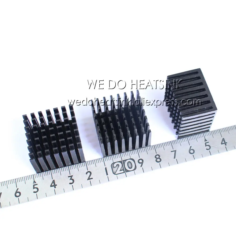

https://www.ebay.ie/itm/10pcs-Lot-28mm-28x28x … t4AAOSwcB5ZLnev
Would these heatsinks do? They’re not copper though, for some reason I couldn’t any copper heatsinks that were big enough to cover the main chips. Also is it worth putting a heatsink on the DAC? I’ve seen some people put a heatsink on theirs.
Reply 12 of 35, by FFXIhealer
The aluminium metal doesn't concern me. It will conduct heat way just fine. What concerns me is the 3M tape on the bottom acting as a potential insulator. There's a reason people use thermal epoxy instead of tape on projects like these. The Epoxy is DESIGNED to channel heat just like thermal paste is. 3M tape is not.

28x28x6mm heatsinks have a lot of cheap sources on eBay, and they fit on the Voodoo2 chips just right. There's some room to go a little taller than that, but I don't think it's necessary.

The 3M type TIM tape is probably a valid option, but thermal adhesive paste will perform better.

I'd like to put heatsink on my V2 (also the v1 to be honest), I bought a stock of 5 from China, they are 28x28x6 mm and they come with 3m tape ready to be used (https://ae01.alicdn.com/kf/HTB11p0oKFXXXXXfXX … XXq6xXFXXXp.jpg)
But i'm still unsure, should I use something taller (https://ae01.alicdn.com/kf/HTB1xY77JQPoK1RjSZKbq6x1IXXao.jpg)? These are 28x28x20.
Should I use an heatsink on the ramdac too?
