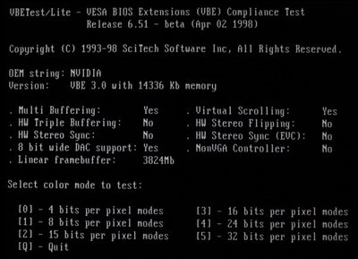

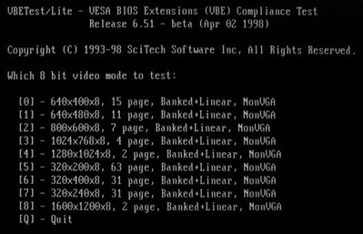

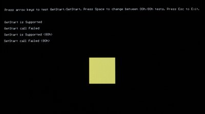

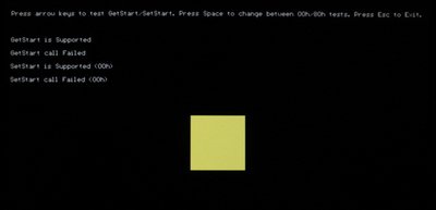

As expected it didn't help (any change in Blood). Maybe because there is still page flipping support reported somewhere in VESA info - UniVBETest reports it regardless TSR loaded and line trest is flickering in all resolution - see below. It's strange that Quake doesn't flicker in some modes (in my case afected modes are: 320 x 240, 320 x 400, 640 x 400, 640 x 480, 800 x 600, 1024 x 768 - about a half of total available modes.
I found a workaround for Blood & Duke - load NOLFBLIM TSR to disable LFB. Then it's not flickering but less performance. It is still playable up to 1024 x 768 so better than nothing. But I'd rather find some better fix. Maybe comparing of good and bad VBIOS disassembly could point the problem. Here's DASM of my runtime VBIOS image, entry point of INT10h handler is at 19D4h

    VBETEST with MSKVBEF7 loaded
    60.36 KiB
    20325 views

    VBEVSTST
    17.37 KiB
    20325 views
    VBEVSTST
