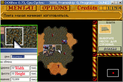

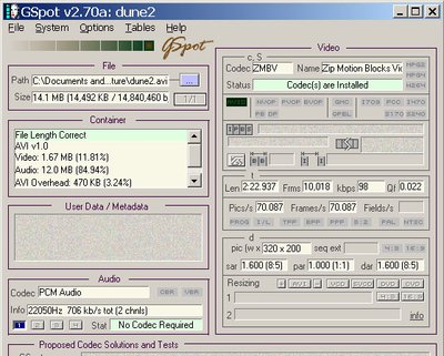

First post, by BOBAH1
if I capture images - the screenshots are in the original quality. But when I capture the video using Ctrl+Alt+F5 , the video quality is terrible. muddy and bad quality. Is it possible to change the quality of captured video?
32.78 KiB
3573 views
dune image
video
11.12 KiB
3573 views
dune video
the original screenshot in *.bmp at the same.

The video should be identical as it is lossless. Do you have the correct codec installed ?

i install ZMBV codec from Dosbox at path Start -> Programs -> Dosbox 0.74 -> Video -> Install Movie Codec . And now this captured video look in all video-players. But in bad quality...
and now i download and test the D-Fend Reloaded with Dosbox, but quality at the same.

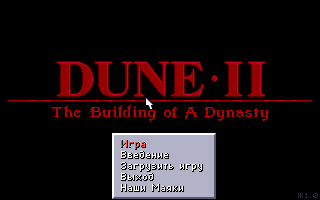

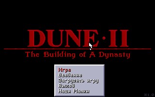

Reply 3 of 28, by BOBAH1
14.78 KiB
3491 views
ctrl+F5
14.18 KiB
3491 views
ctrl+alt+F5

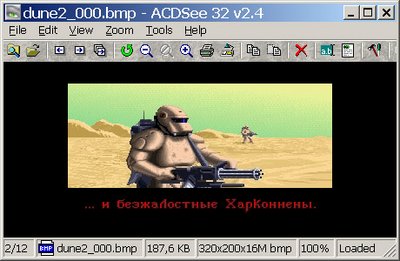

Reply 4 of 28, by BOBAH1
screenshot in *.png:
73.65 KiB
3491 views
Harkonens-1

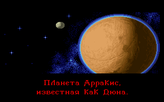

from video:
70.28 KiB
3491 views
Harkonens-2
119.2 KiB
3491 views
dune
