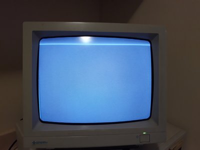

However, when I power down the PC, the monitor displays this image (I then have to also switch off the monitor):
4.2 MiB
982 views
Colour monitor after switching off
Is this "normal" for an older monitor of this type?
If I let the PC stand for a while (say a day or two) and then power up the PC, the monitor initially has some "jitter" which then stabilises as it warms up.
What could be the cause of this and how must I address this?

For CGA monitors at least, this is normal. They show a bright picture when no video signal is present. That's why you normally connect the power cord of the monitor to the PSU of the PC. This way, it only gets power when the PC is on.
Yes, that makes sense.

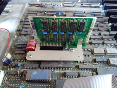

Also, any information about any slots on the motherboard that is not the standard ISA slot (there appears to a pinout for a memory expansion unit).

Yes, on my PC the motherboard has 512K built in and a slot where an extra 128K can be added to make it up to 640K. Mine is one of the later models, the earlier ones had less built in memory and the add on memory modules were different.

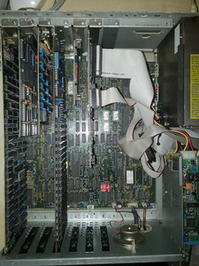

I've attached a top down picture of the (working) PC in this thread - if you look closely, just above the barrel battery, you can see the 30-pin connector for the external memory module. Fortunately for me, on this working PC, it came with an external (after market) memory expansion card that brings it up to 640K RAM.

    Sperry top town view

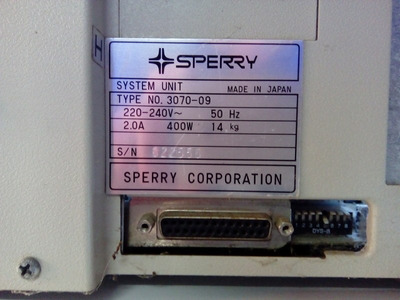

Mine is a model 3070-09. I have attached a picture of the added memory card.

Sperry PC Label

Sperry 128K Memory Add On
