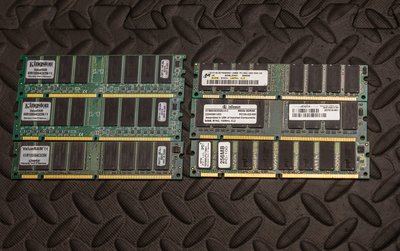

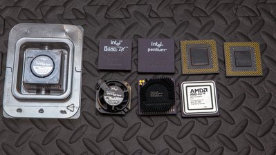

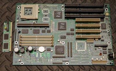

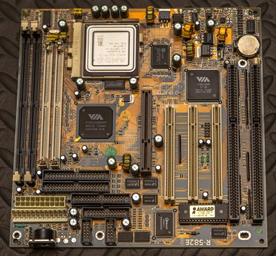

I have an old beige pentium tower I got for $10 some years ago and IBM ThinkPads I've collected. I've just always taken my boxes of "PC Stuff" from apartment to apartment living with little space. It's all from fleamarkets since my original stuff is long gone. There are 10GB IDE hard drives which haven't been spun up since being labeled "tested good 2008." I'm lacking AT power supplies and cases. Drives, cables, adapters are plentiful and there's a 5 photo attachment limit. FX5200 isn't the AGP card I'd choose either but it's all I have other than a PCI GF2 MX and PCI TNT2.

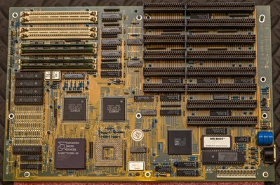

I still need to find out more about the super socket 7 and 386 motherboards and this embedded socket 7 (almost like an itx) board not pictured.
I am cleaning up my ebay watch list now. 😀 I'm also happy that the smallest board is super socket 7 with ATX, AGP, and SDRAM. A compact Win98SE machine would be fun with all this stuff.

Remove that varta battery from the 386 board before it kills it !
Reply 4 of 12, by Skyscraper
I would be greateful if you could make a copy of that MR BIOS for the Forex 386 motherboard and upload it somewhere. To "VOGONS Vintage Driver Library" preferably if it's allowed (might be copyright issues).

And I spot an EXT_BAT header! 😎

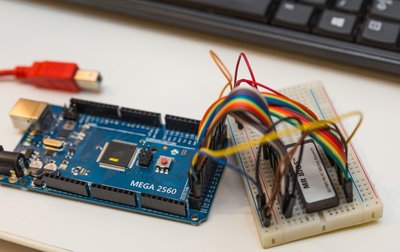

Alright I'll tinker with the 386 board today. I don't have an ISA video card, is there another way to dump the BIOS? I have tools. So far I don't have a datasheet or know what kind of chip that is. Looks like I should be able to dump it with a pickit 3.
Here's what I'll try: http://danceswithferrets.org/geekblog/?p=315

I use another motherboard to do a BIOS dump if I can't get the motherboard in question to run. Boot with the original BIOS chip, switch to the one I want to dump while the system is running and then hope Uniflash can identify and read the chip correctly. 😀
That looks much more fancy and much safer!

It worked!
Also I took the battery out, which also appears to still work! 2.9V?
674.51 KiB
1946 views
April 8, 2018 Correction:
Sorry this file is incorrect! The DIP28 is a 512k not a 128k! Here is a link to the proper BIOS:

Leave the battery out for now and if you want to use the motherboard later connect the battery with some leads soldered to where the battery was connected to keep it some distance from the board otherwise there is a risk the old battery will spill its guts and corrode the board.
If you get a new rechargable 3.6V lithium replacement barrel battery you can solder that directly to the motherboard as long as you desolder it again before putting the board in long term storage (as in many years). Connecting the battery with some leads or using a non rechargable battery pack using the battery header is always a better choice in my opinion though. That said I have soldered new batterys directly to the motherboards my self out of convenience.

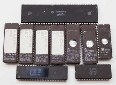

While I have this setup to dump parallel memory DIPs, I wonder if there's any information on these chips. 12.75V, is that a logic level?
677.87 KiB
1938 views
I have modified the circuit to dump the dip32 eeproms. No clue what they're for, but they're dumping.
Reply 11 of 12, by gdjacobs
12V is probably the programming voltage. Modern EEPROMs can be programmed with 5V or less.
