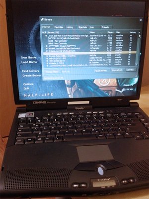

Compaq Presario 1800 is great if you want excellent DOS/Windows compatibility 😜 :
* it has Pentium 3, mine had 733MHz speed
* Ati Rage Pro 128, you can play Half Life and even SVGA mode in Win 3.11 works,
* Sound Blaster compatible ESS Solo-1 Card - full FM synth support (ESFM/OPL3 emulation) and digital sound in DOS games + speakers are pretty good, you can hear the stereophony and a bit of bass,
* has both FDD and DVD,
* has Cardbus/PCMCIA.
Gameport available through docking station, you could probably also solder the wires to the motherboard.
So, everything from DOS/Win 3.11 to XP works (i tried; obviously 98 or 2000 runs better than XP).

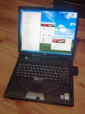

Dell Inspiron 8100 - Pentium 3, I have 1GHz model,
* it has replaceable graphic gard, so I installed a Radeon 9000 64MB pulled from a better model (it had broken BGA memory joint, so I had to replace the balls by hand and re-solder it... https://drive.google.com/file/d/0B2rbHIj6SMlF … 0wtTjkxaG8/view)
* it gets 5600 points in 3dmark 2001SE which is pretty good for a laptop, GTA3 is fully playable.
* Sound card is ESS Maestro 3, which won't work very well in DOS, you won't get FM music for sure.
* You can have an "Ultra HD" (UXGA 😜) 1600x1200 LCD here if you want, but I swapped it with 1400x1050 model because everything was too small for me. 1024x768 is probably also available. I have both DVD and FDD installed, it is also possible to use a docking station with two PCI slots. This machine looks really high-end and expensive feature-wise, it is an 2001 model but performs the same as desktop PCs from that time.
And one more thing: both Compaq and Dell have hardware LCD scaling/anti-aliasing, so DOS games played in lower resolutions won't look like they were stretched in MS paint to fill the entire screen. Laptops with P1 or P2 don't have such features.
+ a little bonus: I also have a 2003 Dell Inspiron 8600 laptop, with Pentium M 2GHz (upgraded) and Radeon 9600/128MB. You can even play Steam version of Half-Life 2 here. But I didn't check Windows 98 compatibility, I put an 32GB SSD here (using an adapter) and installed Win XP. Probably around 10000 3Dmark01SE points or more, I don't remember.
