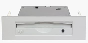

Reply 8 of 13, by dionb
FYI, this is an internal ZIP drive:
Here's a similar pic of a tape drive, like in your systems:
