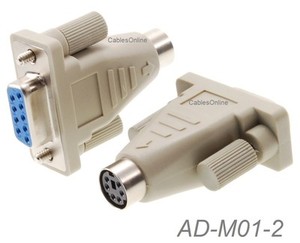

Have anyone tried this adapter with PS/2 mouse? Did it work?
I wonder if it is possible to use it as an easy way to connect PS/2 mouse to my 486.
Reply 1 of 14, by Errius
My understanding is that the mouse must support serial or it won't work. Most mice never had this support.
(I recently tried two different adaptors with several Microsoft PS/2 mice and could not find a combination that worked.)
"AI Requires Proof That You Are Human"
Reply 2 of 14, by keropi
yes the mouse must support both modes in order for this passive adapter to work

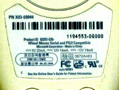

Reply 6 of 14, by PARKE
In the early 90's there was often an indication on the sticker at the bottom of the mouse, like this (these work with the simple adapter plug):
The attachment mouse2.jpg is no longer available
