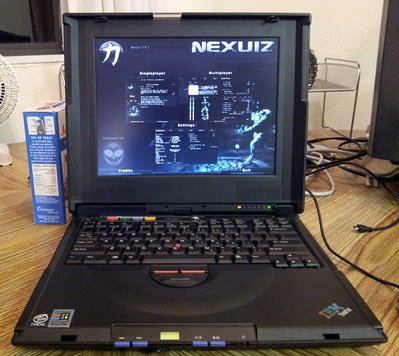

Nexuiz 2.5.2 confirmed working on Win98SE (Kernelex & DirectX 9.0b installed.) Probably means most other DarkPlaces games will work too.
Expect only pain with an 8MB Rage Mobility though.

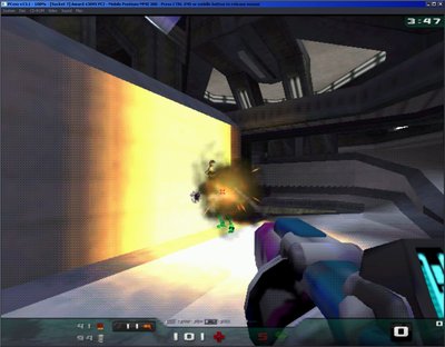

Seems to have a Winsock2 problem in stock Windows98se (desires the winsock2 from XP for freeaddrinfo - this could be fixed by recompiling with ReactOS's wspiapi.h). There was an earlier point in time when that did work in Windows 95... Here's Nexuiz 2.5.2 on PCem's emulated voodoo2 SLI. It's very very unplayable (I argued for LOD meshes in the day but they claimed they didn't need them 😐 )
I did run this on a Voodoo3 3000 a decade back in an earlier 2.x version. It was 'playable' but not much more than what i'm seeing here.
it might, MIGHT maybe help to run a Noesis batch script to decimate all the models down automatically to use less geometry, but that's a theory and etc. theory etc. theory and i forget if a darkplaces that old works with an IQM that new.
