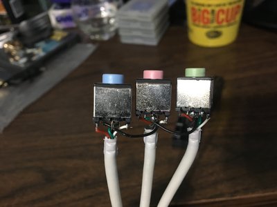

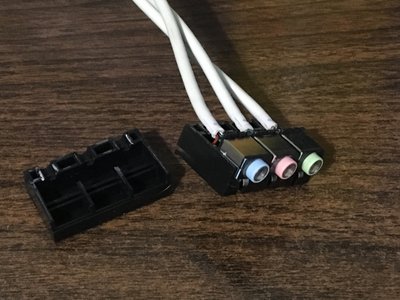

Ok, so new plan. This is what I pulled out of the case:
The attachment IMG_1274[1].JPG is no longer available
The attachment IMG_1275[1].JPG is no longer available
And this is what I found on-line:
http://www.caselabs-store.com/bullet-usb-3-0- … ront-panel-i-o/
I'm thinking, that Caselabs item looks like I can take it apart as well and use the two audio jacks separately from the USB 3.0 jack. Plus, I might be able to fit that USB 3.0 jack into a different case to replace its USB 2.0 front panel ports. I also think I can carefully cut the pink and green rings around the audio jacks on the old computer and glue them onto the HD Audio ports around the jacks there, keeping the color scheme going.
