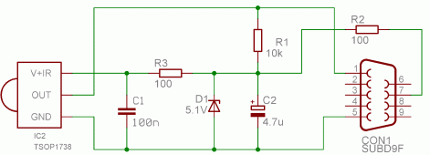

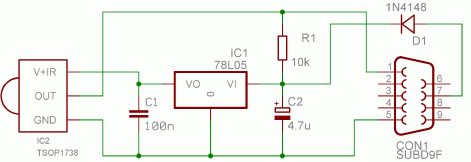

Well, years ago I bought a little irDA adaptor for USB.
I guess it was also possible to make own yourself using the RS232 and a some photo diodes/transistors or so.
Wait, here's a tutorial..
http://www.meblin.karoo.net/IrDAbuild.htm
The attachment IrDAcircuit1.png is no longer available

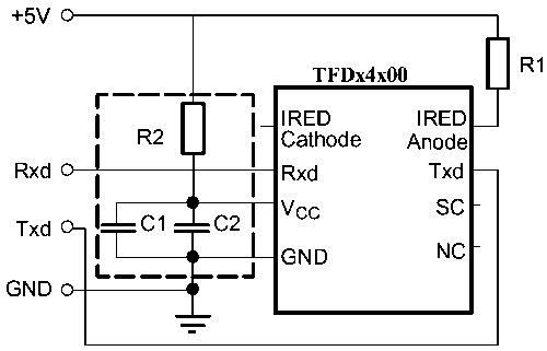

Edit: There's also a kit beeing sold.
The schematics and required parts are mentioned here: https://www.voti.nl/ir-2/index_1.html
The attachment sch-ir-2.gif is no longer available
The attachment sch-ir-2-laptop.gif is no longer available
Edit: Never mind. 🙁 Seems like that this one isn't irDA compatible yet.
