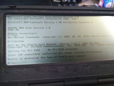

I have a Tidalwave PS-1000 clone, a Okano PT-100, in front of me where i want to use either CF-Cards trough a passive adapter or Flash Cards, maybe even both.
The problem is, tellme.com isn't recognizing the PC Card chipset, see "screenshot" for the output. Darn hard to photograph these old screens. 😅
Any ideas how to get the two PC Card slots in that machine to recognize more than these darn way too expensive SRAM cards?

    "Screenshot" of tellme.com
