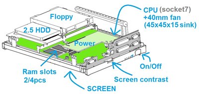

Reply 4 of 6, by user33331
Here I sketched. (Working so no detail photo).
It might be "Siemens-only" motherboard.
The newer PG740 is much better it has 2 slots in it so you can place your own graphic card to it and such.
PG720P has no PCI or AGP expansion slots in it.
    129.85 KiB
    264 views

I can't find any pictures of that online, so to figure out what is possible we'd really need that photograph.
But maybe it's much easier: you're assuming there are no 5V 16b PCMCIA sound cards. That's not true: they do exist. Not common, but they exist. On eBay right now I can only find a cheap one in the US with no cables (Panasonic Sound/CD-Rom Interface Card) or a couple of expensive pro-versions (Digigram Model VXPocket V2) with cables. The thing to watch for is the colour of the connector. Grey/silver means 5V, 16b PCMCIA. Copper/brass means 3.3V 32b Cardbus. So the common Soundblaster Audigy 2 Notebook adapters are Cardbus and not usable here. Good chance you can find something usable within a few weeks.
