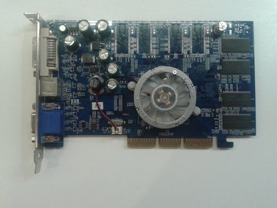

Is there a way to tell which bus width a GPU has, just by looking at the card ? This info is often not easy to find, I was wondering if we could calculate it from the ram chips datasheet.

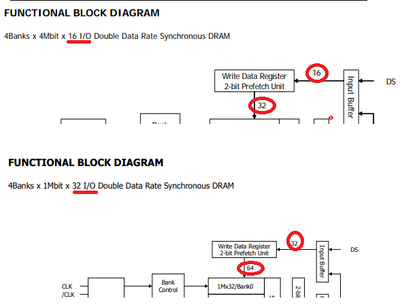

For example I have two geforce 4mx440 cards, both have four memory chips on board :
- The first uses HY5DU561622CT-5 chips, labeled as " 256M(16Mx16) gDDR SDRAM" https://www.skhynix.com/eolproducts.view.do?p … =04&rc=graphics
- The second uses HY5DU283222Q chips, labeled as "128M(4Mx32) GDDR SDRAM" https://www.skhynix.com/product/filedata/file … oad.do?seq=4243
Does the "x16 / x32" in the chip description means their bus width is 16bit / 32bit ? So we could guess the first card has 4x16 = 64bit bus width, while the second has 4x32 = 128bit bus width ?

Reply 1 of 4, by lazibayer
The first one is 64bit. The second one could be either 64 or 128bit, because two chips can share the same data path.

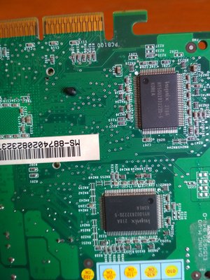

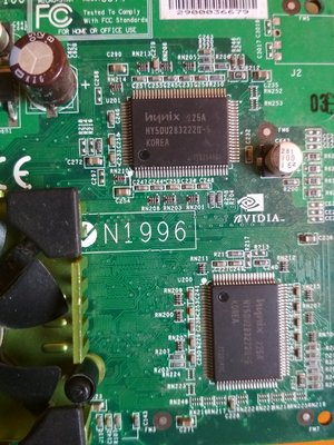

Reply 2 of 4, by okenido
You're right for path sharing, looking at the pcb it seems they are fairly independant
The attachment IMG_20180331_122726.jpg is no longer available
The attachment IMG_20180331_122708.jpg is no longer available
I'll give it a try to see if the guessings are right 😀
Reply 3 of 4, by The Serpent Rider
That's reference GeForce 4 MX 440 board. They all were 128-bit.

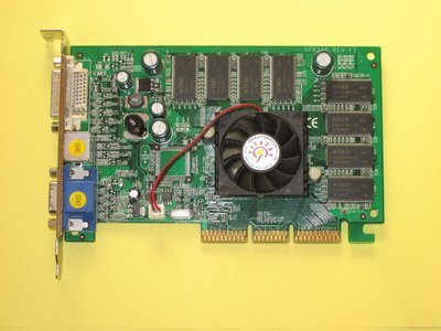

Reply 4 of 4, by shiva2004
With late 90s/early 00s videocards most of the time it's simple: if you see a card with very obvious soldering points for additional memory chips it has a 64 bit memory bus, if not it's a 128bit, the reference design is the same and basically the wider bus uses more chips; later it become more complicated because 64bit and 128bit versions of a card started using different designs.
The attachment $_57.JPG is no longer available
This is a card with a 128 bit memory bus
The attachment $_57_2.JPG is no longer available
And this one has a 64 bit one

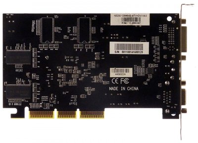

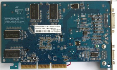

Sometimes there are memory chips on both sides of the card:
The attachment fx5200_bhq.jpg is no longer available
128 bit
The attachment 128MB-QDI-GeForce-FX5200--AGP-Grafikkarte--VGA-DV_4.JPG is no longer available
64 bit
