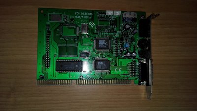

Maybe a strange question but I am total DOS machine noob. ANyway I have an Amiga 3000T with a so called A2286 bridgeboard in it, best to compare with Commodore PC30 or so on a card.
Anyway I did put in this card because PnP can be disabled.

Now I use prince of persia to test sound, the game runs fine on my 286 and it seems to support lots of sound choices. Now I wonder what does my card support, if I choose Soundblaster in Prince I have sound ? But one of those chips is a wavetable (I think ) and in my ESS config.exe there is an entry called MPU-401 ... assuming that makes sounds of it's own what do I have to choose in game to make that work ? Or am I at the wrong track here ?
I am afraid the card has no wavetable hardware, just this: "ES968F Audio Effects Processor (mixer expansion) for Chips without integrated 3-D audio processing."
