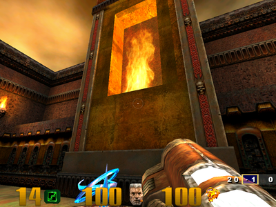

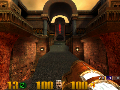

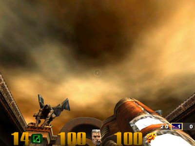

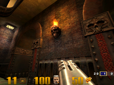

Accorsing to the Quake 3 benchmark thread my Voodoo 3 3000 is fine performance wise but I am not so sure about the IQ. Are the below screenshots the normal affair for a Voodoo 3? I am particularly irked by dithering in transparent textures and alpha blending, most noticable in things like the flames and the skybox? Was this how it aleays was? It gives me Rage Pro vibes when I play..
Max details, 32 bit textures and rendering enabled.

Reply 5 of 10, by appiah4
Choosing Texture Filtering Quality as High and Alpha Blending as Sharper seems to have helped immensely at the expense of around 5% performance loss.
Reply 6 of 10, by leileilol
The overbrights in Quake3 requires the whole scene to be generally made darker (128 or 0.5 at best for many textures) for a higher lighting volume, pretty much halving color precision (on any hardware) with the brightness automatically cranked up. This will also make the dithering (as well as the screen filter) more obvious. Ignorance to this overbright-related loss has fueled many fanboy arguments in the day...
Setting r_overbrightBits to 0 will cause the textures to appear less banded, less dithergrainy at the expense of brighter lighting.
Another thing to keep in mind is that Quake3 uses the lossy JPEG image format for the majority of their 24-bit textures. Installing and playing Team Arena will alleviate some of this as that ships lossless TGA replacements for many of them.
