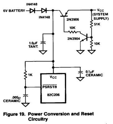

The M6264CP20 chip is more likely to be a 8K * 8bit tag ram.
The RTC / CMOS RAM should be inside the H82C206 chip above the M6264CP20 chip.
The diagram in the datasheet includes a 6V battery, which is higher than the commonly used 3.6V batteries of that time. I'd say try with 3x 1.5V batteries and see if it works.
