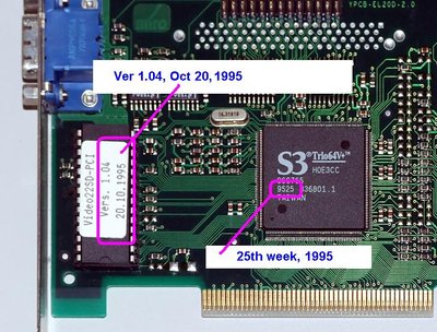

Reply 7 of 11, by fsmith2003
I know for sure that the 64V+ was around in 1995. I do have one of those and it does show production dates in '95 on the chip. I know there are some Virge cards that also show 1995 production dates but I do not believe they were made available until early 1996.
Reply 8 of 11, by PCBONEZ
May have been one of the samples they send to manufacturers so they can design the rest of their video card and test it.
