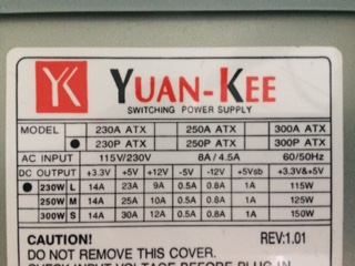

Reply 4 of 7, by gordon-creAtive.com
This is the rating of the PSU:
40.6 KiB
1040 views
I detached everything consuming power from the PSU and the mainboard except for the CPU and the 9700, but it still won't coldboot. I'll do more research to find out if the PSU is to blame. The caps on the card are not bulging, is there any way to check them like with a multimeter?
Update:
According to this german article the 9700 Pro draws ~150 Watt in the BIOS screen and probably even more on startup. So regardless to which rail the 9700 is connected, my PSU does not provide enough power I guess (or can it draw from both rails at the same time?). I'll connect one of my modern PSUs and see what happens.
Reply 5 of 7, by The Serpent Rider
That's full system consumption. But your PSU is weak in 12v rail department.
Reply 6 of 7, by gdjacobs
That PSU is a stretch for anything above a basic P3. Also, it's possibly not good for it's rated amps.
