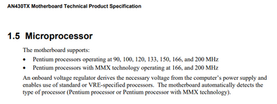

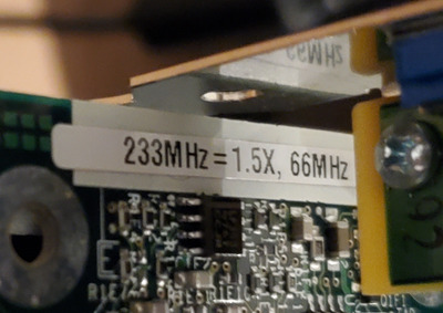

Reply 6 of 12, by Kahenraz
Speaking of VRMs, I've been wondering how Intel says that it can support the Pentium 233 MMX within spec. I only see a single linear voltage regulator that outputs 3.3V. Does it not have a second regulator for the split voltage?
My board is even labeled as supporting the 233 MMX, which was only shipped with a split voltage.

Reply 7 of 12, by Kahenraz
I found another section in the documentation that talks about this. I confirmed on the Vout pin that when a processor that is detected as "MMX" is used, the output voltage is set to 2.9V. It should be possible to reduce this further by adding a resistor to the ADJ pin on the regulator, I think.

Interesting subject, i have the same board (with sticker) running a 200 MMX and have a 233 MMX upgrade available. I still have to look into the changes to get it running. With the sticker on the board you would assume it's safe to install a 233 MMX.
Reply 9 of 12, by Kahenraz
The 200 Mhz MMX will overclock to 233 easily. You have to set the jumpers to select it either way, whether you have the specific processor or not. So, you may as well try it and see if it works. I'm already using a 200 Mhz at 233 Mhz as well.

I think I was mistaken. The processor is probably pulling 3.3V from the ATX power supply. This VRM is the regulator for the split voltage.
Reply 12 of 12, by The Serpent Rider
Kahenraz wrote on 2024-03-03, 11:59:
No, ATX has allowed simplified design. On Intel 430TX mobos, I/O and memory are powered directly through +3.3v rail and processor is powered through adjustable linear voltage regulator on +5v rail. So there's no need for AT workarounds like split rail - everything except CPU is powered directly from PSU.
