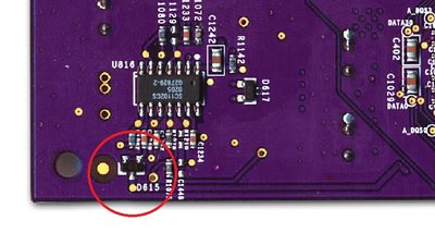

Need help identifing missing component on a Asus V8460 Ultra GFx card.
Missing component is D615 on back of card low left corner.
Thanks

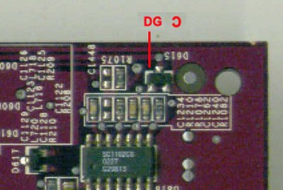

Just by looking at given photo, you can tell that it's a silicon diode, probably with a part number of D5, which is a center tapped diode. You can substitute that SMD part with any silicon diode of the same or greater current rating.

Thanks to both, will this component alone prevent the card from even post? When I got the card I tested it in varius motherboards and it didn't post in any, so I started looking at the card closer and its the only component missing.
