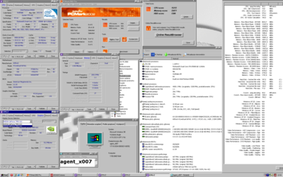

I didn't wrote I used GTX 780 Ti in Windows 98SE...
However, GTX 780 Ti was installed in PC while it was running Win 98 SE.
As for 512MB+ VRAM, GX2 is simply special in this case :
249.07 KiB
334 views
