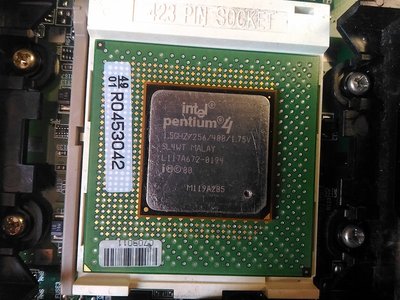

The millenial troll PC - A Socket 423 Rambus build
First post, by Munx
Why are the Pentium 4's so hated? Is it their super high clock-speed that AMD fanboys could only dream of? SSE2 instructions that future-proofed these CPU's and allow them to work with Steam, something that even Athlon XP's can't properly do? Or maybe it's because S423 motherboards are made for a newer ATX standard an don't require hunting down ancient 5V PSUs to work? Lets find out with the help of this 1500MHz Pentium 4, the FASTEST CPU of Y2K!

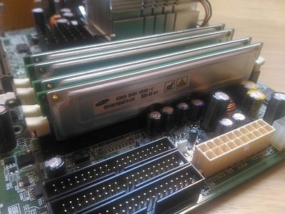

A good CPU deserves a good motherboard - ASUS P4T-I, loaded up with 512 Megabytes of PC800 RDRAM! Delivering a whopping 3.2GB/s of bandwidth, something the Athlon losers still stuck on ancient PC133 RAM can only dream of!

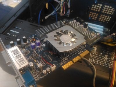

A build this powerful needs a beastly graphics card. Looks like a perfect job for Geforce FX!
FX5900XT by XFX will make sure that any game on this machine will be played The Way its Meant to be Played™!

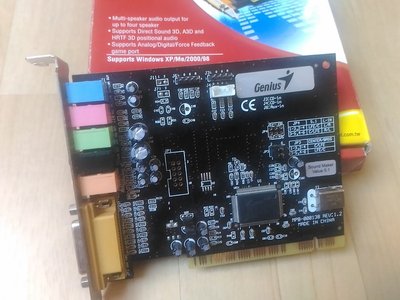

Lastly, we will need some accelerated 3D sound, something the integrated sound chip can't provide...
Should I go with Vortex 2 and A3D to get the best possible sound for the 90's? Or look to the future with a Creative Audigy and EAX?
Why not both? AND for 1/10th the price? Presenting the Genius Sound Maker with the CMI8738 chipset, supporting all the 3D sound standards you could ever wish for!

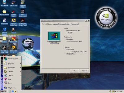

To finish this build we'll need an OS. What better choice for a new millennium build than Windows ME! Not only is this OS the last DOS-based one from Microsoft, which means it's perfected and refined for stability, but it's also packed with modern features, like system restore!
