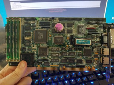

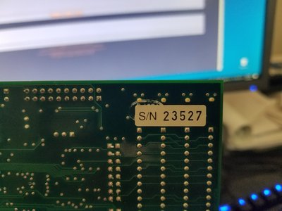

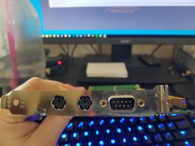

I have an ISA card here that I can't seem to get working. And, to be honest, I'm not entirely sure what it is. I see it has FD and HD headers and, presumably, a serial port and a couple of PS/2 ports. But still...anyone have any idea?

It looks like it's a complete PC on an ISA card. There is an AMD 386SX CPU on there, and also a BIOS chip, memory, an Opti chipset and everything. The empty socket is probably for the 387SX coprocessor.
It is probably some sort of industrial PC card, supposed to be installed in some kind of ISA backplane case.
Reply 2 of 11, by SW-SSG
Indeed, that's an SBC (single-board computer). One needs a suitable backplane to make use of it; plugging it into any old motherboard won't do very much.

There is a Mr Bios ROM on your card. Would be great if you could dump its content and make it available to the community.

Also don't count on this being an ISA connector. I mean pin-wise it may physically fit, but there's a strong chance that it's not electrically compatible with an ISA slot. Which in its turn means that you can damage the card by inserting it into one.

Indeed a dump of that BIOS would be nice. I think I have a 386SX board based on the same OPTI 82C291 chipset...or maybe it's the 293. Either way, that SBC is nice because it has 64kb cache, a rare feature on a 386SX.
