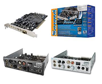

So recently I got a Dell motherboard, and its all up and running now. I have power, Windows XP (SP3) is installed, the Geforce ti4200 works and is running...
The only hitch is the Soundblaster Audigy 2 (which may or may not be a ZS, I'm not sure how you can tell).
For some reason there is NO SOUND coming through my speakers.

Maybe you could post a picture of your cards, or at least let us know the SBxxxx model number on them.

Just checked, the model is SB0350 on both cards.

This should be the Audigy 2 ZS.
The digital out port is for digital speakers. Most standard speakers will use the regular line-out (line-out 1 for stereo). On the ZS the first line-out is the third jack counting from the Firewire port. It may be green or gold.
There is a setting in the audio drivers that can enable digital audio only. If you have that ticked, but connected to the normal line-out, you'll get no sound. And if you connect via the digital audio to normal analog speakers, you will get no sound.

No, the live drive ( breakout box ) is not required.
I have a Dell 270 too, I remember having difficulties get sound cards to work in it to.
But I was running Win98se. Should be easy in WinXP. Check your bios setting and reset to default.
The Audigy 2zs is plug and play in Win-10 so if you have a Win-10 computer with PCI slot then you can try it there.
Check you resources and driver in "Control panel > device manager" to make sure the card is working okay.
I have several of these Audigy 2zs cards and I am using one right now in Win-10 on an HP 6300 Pro computer.
I have never had one of these cards go bad on me.
For the live drive you can use a standard 40-pin cable.
The black cable is for firewire.
However the live drive is NOT required for the Audigy 2zs to work.
