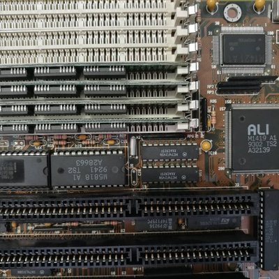

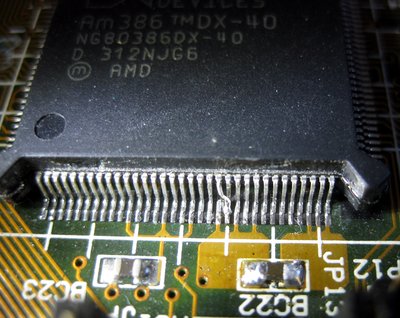

I just recently decided to upgrade my 386. i bought 128kb of cache to reach 256kb, I changed the tag ram to address the bigger cache and configured the jumpers. i added 16mbs of ram. everything worked fine. Then i decided to put a 486dlc on the secondary socket. I turned on the pc and both cpus seem warm but the screen shows nothing and there is no sound from the pc speaker to indicate what's wrong. any ideas?
Reply 1 of 64, by Phido
I would remove the ram and put in the smallest amount that you knows works.
Is the CPU inserted correctly? Do you need to configure any jumpers to disable the on board cpu.
Try disabling your cache or reseting the cmos.
Also in your pictures there is no power going to the motherboard, I assume you have connected the power when you tried it.

The problem is that you already have a 386DX-40 soldered to the board. There may be a jumper to disable it. If not, the only option is to cut off the CPU. You have to be really careful doing that so that you don't damage traces. I had a similar problem with my old ALi 386 board.

Reply 6 of 64, by jesolo
I would first try and identify your motherboard to see what the function of each jumper is.
Try this site: http://arvutimuuseum.ee/th99/#1
Based on your first picture, there are jumpers at JP5 & JP6 (close to the cache) and below your memory. Next to that appears to be a JP2 that doesn't have any pins and also JP7 & JP8 (next to the CPU's).

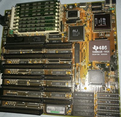

the 2 jumper sets close to the cache chips are for configuring the cache size. the board was bought some time ago from ebay so i don't have any documentation. but based on a sticker on it and some googling it should be an abit fa3.
Reply 8 of 64, by balthazor4ever
after some searching i found a motherboard that looks like mine. http://arvutimuuseum.ee/th99/m/C-D/32319.htm
it has three jumpers for the 486dlc jp9 jp10 and jp11. there are contacts on my motherboard but no soldered jumpers. could they be the ones I need to close? how could i test them?

Reply 13 of 64, by balthazor4ever
386 KMC-A419-8 motherboard and ram i found this here on vogons. in the last image i see it doesn't have the 386dx soldered but also has jp7 pins 1-2 closed and jp9 jp10 and jp11 closed with some solder.

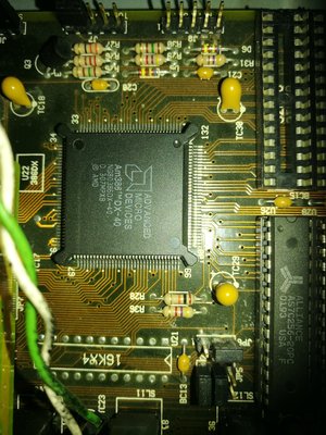

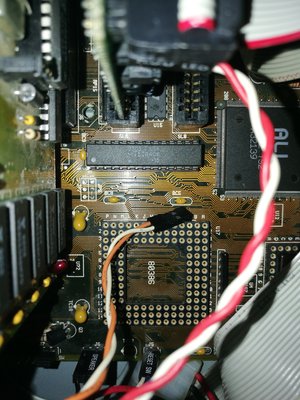

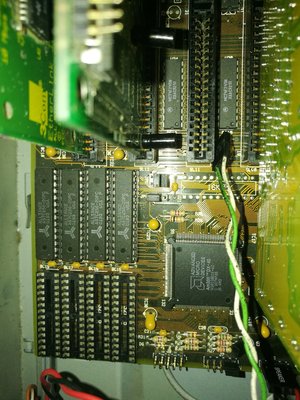

Wait, I haven't read this thread yet, but wanted to stop you from cutting off the Am386DX. You only need to set FLT# to GND on the Am386DX to disable it. I've done this on 4 motherboards and will send you a photo of how to do it.
Reply 16 of 64, by feipoa
In the photos below, I am connecting FLT# to GND. This sets floating all the pins of the Am386DX, but it is only for certain model numbers of the Am386DX. I'll have to check my previous post - this is where I mentioned which revision of the Am386DX can do this. I think it was C or later.
What I have done in these photos is to desolder the FLT# lead and solder it onto a connected GND lead.

Reply 17 of 64, by feipoa
This FLT# mod trick first appeared in one of my posts on another forum, namely, https://www.eevblog.com/forum/repair/how-to-t … n-oscilloscope/

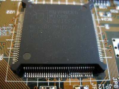

Looking at the Am386 spec sheet, it mentions that FLT# is only found on the PQFP format for the chips (which is what you have) and is for rev C0 or later. If you have a better photo of your Am386DX, we can determine if it is C0 or later.
I do not understand why your board contains a a PGA132 socket, yet no jumper to set FLT# to GND. My board was similar.
Reply 18 of 64, by balthazor4ever
Here are some more photos. the only difference i found with a motherboard with the exact layout are jp7 jp9 jp10 and jp11. maybe jp7 is the flt jumper.
Reply 19 of 64, by feipoa
Looks like you have rev D, so it contains FLT#.
Does your motherboard contain JP7? If so, use a multi-meter to see if it goes to the Am386DX pins that I'm using in my photos.
