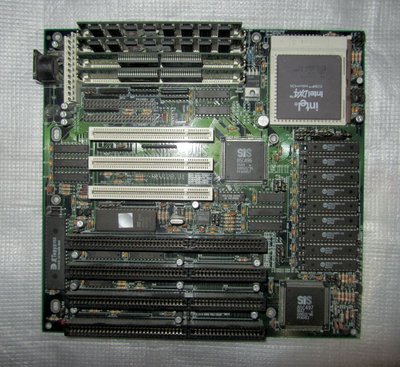

This board:
The attachment SILICON STAR PI4-PI4T PCI.jpg is no longer available
Markings on the back:
LITE ON 20V0
9546-03
486IP-B-2-A
Initially I thought that it was Silicon Star motherboard (PI4/PI4T PCI), but jumpers don't match 100%. I'm also aware that Soyo had the same design (SY-030G/H), but jumpers are different too.

Wim's BIOS says it's mf'd by Beyond.
BIOS string: 10/02/95-SiS-496-497/A/B-2A4IBB61C-00
No jumper config information unfortunately.

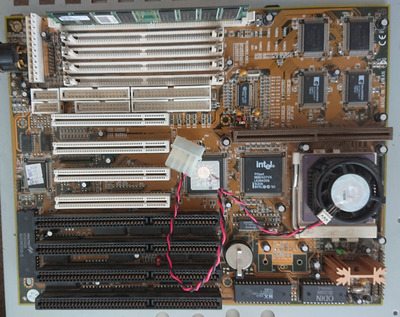

Reply 11 of 11, by FelixNZ
