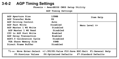

Reply 7 of 16, by SW-SSG
The wording is a bit vague but the IGP-related settings are actually under "AGP Timing Settings" in the BIOS. (This is because the IGP in VIA chipsets is attached AFAIK using an internal AGP link.) "VGA Share Memory Size" will adjust the amount of system memory used as the IGP's frame buffer, and you can try adjusting this and the other settings to see if you can get a positive result.

Reply 9 of 16, by SW-SSG
To me it sounds like the video memory might be overwritten somehow by the OS upon loading the driver (hence, right after the Win98 splash screen). To that end, you could disable "Direct Frame Buffer" if it isn't already, as that seems to control whether or not the CPU can directly write to video memory and possibly cause problems. Failing that, you could try allocating more "share memory" to the IGP while making sure the "Aperture Size" is always set larger.

Reply 11 of 16, by mrulrich
Thanks for this suggestion. Everything mentioned above was already set as described.

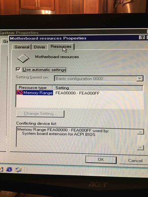

Reply 13 of 16, by mrulrich
So I ended up installing a PCI graphics card (which has shutdown issues and is another story). But, after installing the driver from the VIA driver archive, I did find the yellow icon over the VIA/S3 display adapter, indicating some sort of conflict. That conflict, I assume, is preventing the desktop from displaying upon boot. I'm wondering if something else on the MOBO is conflicting with the display adapter? Is it possible that its a hardware issue? Seems strange given everything else works well. I think I'm past any sort of refresh rate issue and I'm not assuming its some sort of firmware problem. I'm at the end of my troubleshooting rope.
Reply 14 of 16, by mrulrich
I noticed the conflict shown in the attached image. Could this be related to my issue?
