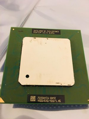

Im attaching a picture of my Tualatin cpu. Is the 512kb cashe a problem ? are there other versions with more/less L2 cashe ram?
Reply 3 of 12, by zyga64
512kB cache is not a problem at all, it provides increase of performance in opposite to regular 256kB versions.
However those 512kB cache processors were intended to use in servers (P3-S as "S"erver), so desktop boards does not have to provide microcodes for them. Anyway, many of desktop boards supports those out-of-the-box.
BTW. I have exact the same processor as yours.
