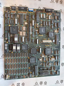

So i found this little wonder
I added 1mb (8 x 256x4mbit 20pin dips)
attached HD 260mb
changed CPU from Intel 10mhz to harris 16mhrz (but it still works as 10Mhz) - there's no settings in BIOS or jumpers on MB. At least no clues wich jumpers could be used
Tried to set Audio card OPL3 and VIBLRA16 - no luck
ctcu and OPL set utility don't see cards
This is my first experience with 286, and i found that this mb is quite rare
So i have few questions
How to change CPU speed?
Wich sound card will work with this motherboard?
Is it possible to install Co-processor? Which one will fit?
What for 3d memory BANK of 16 pins sockets?
does anybody have manual or instructions for this MB?
What means RAM BIOS option?
Is it make sense to use EMS? an actualy how?
i can set 384/512 or 1M or 2M...
but it seems not working

Hi, while I can't answer all of your questions at the moment,
I'll recommend you to try installing EMU386. 😀
That's an 386 emulator for 286 machines.
It *sometimes* helps running newer DOS programs on a 286 (example1, example2).
In simple words, it does so by emulating certain real-mode instructions that the 386 got, but the 80286 is missing.
Getting Creative drivers to work was one of the main uses for this program.

Reply 3 of 11, by canthearu
You will likely need to change the crystal to make it run faster, but the ISA bus and memory are probably on the same clock bus as the CPU, so no guarantee they will work properly if you change to a faster crystal.
Edit: you should also try one of the ESS audiodrive ISA cards. Their configuration utilities do not need 386 instructions to work (had it partially working on an XT class machine with an 8-bit bus)
Reply 4 of 11, by SW-SSG
An 80287 would likely go into the empty DIP socket at bottom-left of your photo, but you might need to solder in additional parts (e.g. a crystal oscillator) in order to get it running.

Reply 10 of 11, by epictronics
Old thread, but there probably aren't that many of these boards out there, so one thread here is probably enough to rule them all : )
Apparently, my Canon A-200EX II HD20 has a very similar board to this Acer 915p (N) board.
I'll post a few pictures in case they are useful for someone

Reply 11 of 11, by nilsnegativ
epictronics wrote on 2023-01-15, 19:02:
Well, I have one of those!
I have no idea where it came from, my Dad gave it to me sometime in the 90s and I used it as decoration in my room. Yeah, believe it or not.
Until I saw you video aboit the Canon A-200EX I had forgotten about it. Now I want to see if it still works!!
I am facing a set of interconnected problems here though...
I don't have the ISA riser board so I cannot use a VGA card and no diagnostic board. I have no EGA monitor or converter. And I don't want to buy one until I know it still works.
