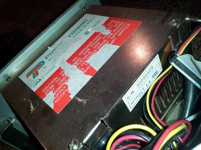

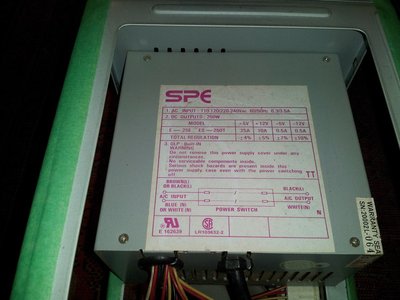

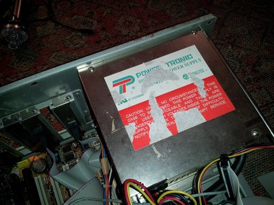

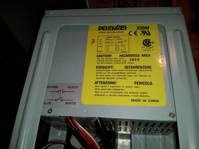

Any opinions on these? They all look pretty bad TBH. I'm dealing with some old AT desktops/minitowers out of my storage room; probably going to keep two and get rid of two. If there's any specific ones I should save, let me know ASAP.
These all seem to work, but they've endured several summer/winter cycles in a musty, humid, un-climate-controlled trailer, so who knows for how long.

The "Solar Power" one is in my workhorse DOS PC from back in the early 2000s; I used that thing almost daily for a while.
Reply 1 of 13, by SW-SSG
I only recognize the Premier name; these are from the ATNG factory (as the label on yours appears to corroborate) which seems to be known for cheap but generally OK units. I would keep that one, at least.

From what I've read on BadCaps, the Power Tronic is actually, a good OEM unit, which Gateway used. The Solar Power and Spectre seem to be less desirable units.

The Power Tronic has 1990 date labeled on it. ES-250T Solar Power has 2002, the other SP 1998. ATNG built Pemier can't be too old.
As others have suggested you should open them up and insepct for signs of ageing. I've had "new" off-the-shelf FSP bulid AT units with bulging capacitors and regulation problems...
