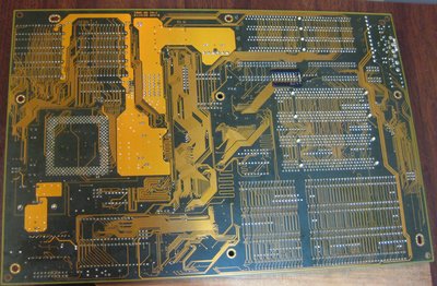

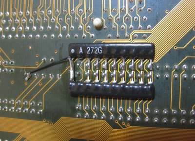

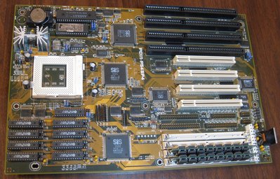

I have an Asus PCI/I-P54SP4 Rev. 1.5 socket 5 motherboard. On the bottom of the motherboard, there appears to be two resistor packs soldered to the pins of the primary IDE connector. It looks like some kind of after thought, either by the end-user or the factory. Does anyone else have a motherboard with this resistor network soldered on? And do you know what its purpose is?

Can't help you feipoa but it definitely looks like an end-user modification judging from the way the legs on the resistor packs have been cut (too long) and the way the single wire is connected to the other pack without any protective tape. Still a clean job though.
I wonder if they were attempting to attenuate the signal on the data lines, or conversely, raise the TTL low-state voltage to whatever that black wire leads to if that makes any sense.
What is that black wire connected to? is it a ground?

These are pullup/down resistors on the data lines, probably to correct some sort of a timing issue or problem when no cable is connected or something similar.
Reply 3 of 6, by SW-SSG
As a side note, the IDE connectors on that motherboard are handled by the infamous CMD 640B controller with various data corruption bugs. Not sure if that has anything to do with those mods, though.
Reply 4 of 6, by feipoa
The black wire just connects to Vcc, so the resistor arrays are pull-ups as Tiido suggested. I'm just wondering why its there. My first thought was also wondering if it was some hack to lessen or prevent the CMD corruption bug.
