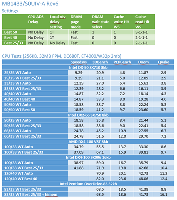

Reply 10 of 26, by sunaiac
Something like that ?

Reply 11 of 26, by aries-mu
Woooow man that's TERRIFIC!!! THANKS!!!!
Very very interesting....
Surprised to see how superior the DX2 66 is VS the DX50, despite the faster bus of the DX50... I wonder what the speed of the DX50's controller and ET4000 W32 were... VERY IMPORTANT DETAIL!
Surprised to see how important is and how huge the impact is of the 16 KB L1 cache VS the 8 KB one for same CPU. Maybe because of the BUS:CPU imbalance of the DX4 CPUs!
Surprised to see how faster the DX4 120 is VS the Pentium Overdrive 83 !!! Except... in Quake! Maybe (relatively) modern game had started to be optimized for Pentium instructions...
Would have been also interesting to see how a DX2 80 and a DX2 80 with 16KB L1 cache (if existed) would have behaved under those different settings.... And also, all those CPUs with cache in Write Back and same everything else as shown....
Wonder why the huge impact of Himem on Quake though....
Wow, there's so much to say about that table... so inspiring and interesting!!!

Reply 13 of 26, by sunaiac
Aries-mu, it is important with a limited set of data to not jump to conclusions too quickly. Else you can prove anything you want 😀
The difference between the two dx4s here is not only 8k vs 16k, but also intel Vs AMD. At same cache quantity, intel's is already quite faster than amd's.
As for the pentium OD, this mainly gives an idea of its performance in a motherboard that does not support it well.
You can refer to the table in the other thread where I used more CPUs and a mb8433 to validate that.
Basically this table is more representative of the DX and dx2 performances.
And yes, the dx2 66 is much faster than a dx50. I have no idea why ppl keep repeating that urban legend saying they're more or less equal. See how I had to lower timings for the 50mhz bus. And that's with a very fast and stable vlb video card.

Reply 15 of 26, by aries-mu
Right!!! I didn't notice the AMD/Intel difference!!! Thanks.
And, I didn't know AMD was slower than Intel per se (like, even if let's say cache is identical). That's too bad. Because Intel never made DX 40s, DX2-80s, and DX4-120s, which I like a lot. Actually, if we exclude overclocked CPUs and various 5x86 CPUs, the DX4-120 is the fastest pure 486, officially "486" labeled, ever released. If then it has to loose a little bit of performance because it's AMD, then I'd totally have wanted an Intel DX4-120 released!
What thread? I'll search among the threads you created... just in case I won't find it, the link would be appreciated, thanks.
EDIT: I found it, thanks!
Wow man! S3 Trio and DX4s at 133 MHz and Quake is still stuck around 10 complaining??
Yeah this sounds very surprising for me too.
What's the very fast and stable VLB video card? Are you talking about the Tseng ET4000 W32?
I'm surprised because we have +17 MHz on many things (FSB, RAM, Cache, Bus, cards, etc.) vs -16 MHz only on the CPU, and still the difference of performances is huge! Is that timing thing so important?

Reply 16 of 26, by sunaiac
The speed difference between 486s from AMD and intel appears only at dx4 level.
The dx2 66s are pretty much equal.
AMD's dx4 is probably just a faster version of their dx2 while intel seems to have made some improvements.
As for the bus speed, remember results I show are video games. They should be less dependent on bus speed than more serious applications. Also, when you have 1 cycle of wait at 50mhz, that can be as bad as running at 25mhz without waiting between memory accesses.
The et4000 w32 are amongst the fastest vlb cards for dos gaming.
Now don't get me wrong, the dx50 is an extremely cool CPU, in my top 3 486s with the intel dx4 writeback and the 40mhz UMC super40 😀
But mundane CPUs like the dx2 66 and the AMD dx5 133 are faster.
You are safe with your dx4 120 choice. It is the fastest non overclocked non 5x86 CPU if not run on a 27mhz PCI bus 😁
